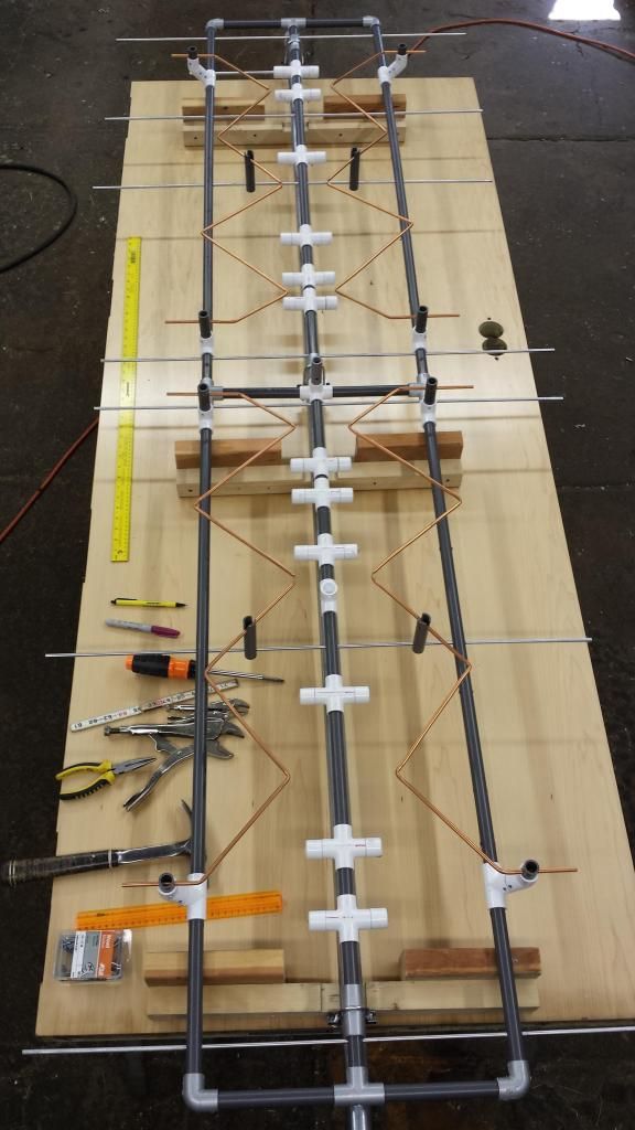

From there it was off to big help custom building an antenna. (4nec program - check out the digitalhome site for assistance - this will take months). Here is a computer look at the Gray Hoverman 10 via nikiml's site.
Paired with a Kitztech prototype KT-500 variable low noise amp got my UHF at 95%, but backside was not always perfect and sometimes WDAF would drop. Not acceptable - football games missed. Here I was doing some testing on the house before swapping it out.
Much improved but not perfect - work with nikiml and model a new prototype Double Bay GH 20. This took months running 24hrs a day on an i7 Quad core computer. That is a commercial door that is 3' x 8'.
