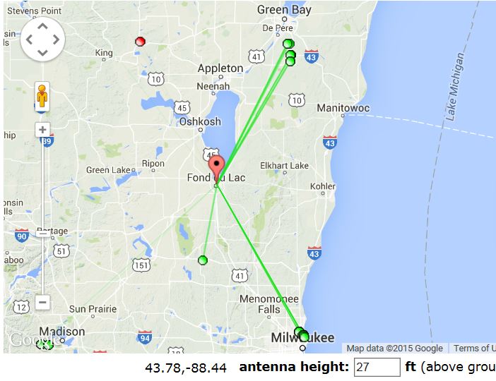

I did two FMFOOL reports to see if there might be any strong FM signals that might interfere with TV reception. It might be a good idea to insert an FM trap/filter between the antenna and the tuner. Some preamps have an FM filter.
One report is based on the short coordinates of you tvfool report. The other (est2) is based on my estimate of your location near E Johnson St (23) about 2 blocks SE of the All About Life Rehab Center. See attachments 1 and 2.
FM reports don't link like TV reports, so an image is used.
You can do your own using your exact address or coordinates here:

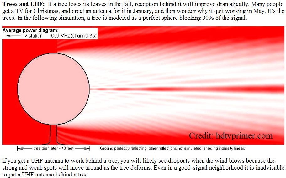

When I read that at this time of year, I think of trees growing into the signal path. See attachment 3.
When aiming an antenna I first do it for max signal. Then I monitor signal quality as defined by SNR and errors to optimize aim. They aren't always at the same azimuth.

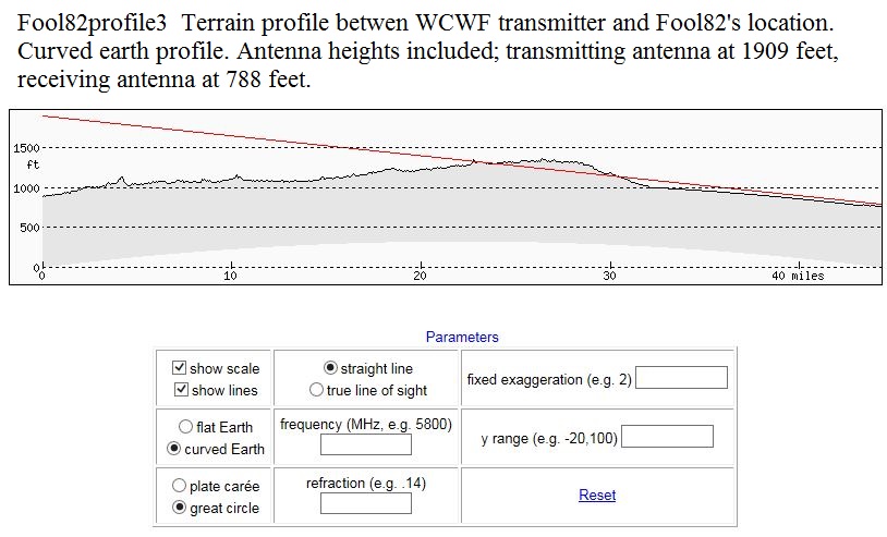

I don't think we have been much help with your WCWF problem and I'm scraping the bottom of the barrel for ideas. There must be an unknown factor. You haven't told us much about your system inside the house.
They could be running reduced power because of transmitter problems. You could call the station engineer.
You could have local RF interference from other services. We have a local paging transmitter that messes with cable channel 19 (150 to 156 MHz). You could have electrical interference from switchmode power supplies, like AC adapters.
But I doubt just an external FM trap on the VHF antenna would be needed as the only VHF station broadcasting WLUK Fox 11 is coming in fine.
That is the conventional thinking. I still think FM interference should be considered. It still could be fundamental overload; your strongest FM station is 60 dB stronger than WCWF.
It is not in your best self-interest to reject a new idea just because it doesn't agree with your old idea. Didn't you come here for new ideas because you were having trouble?
Looking at the terrain profile between WCWF and your location, it isn't too difficult to imagine buildings or trees popping up above the terrain, not to mention the interference from the 1st Edge peak.

This paper outlines potential improvements in the modeling, methods and procedures now in use for prediction and measurement of DTV service.
INTRODUCTION
Early on, even before the 8-VSB standard was adopted, it was suggested that low-power HDTV transmission, as low as –12 dB average power relative to NTSC peak visual power, would provide for service replication to at least the Grade-B contour of NTSC stations.
It was generally thought that with incident field strength of 40.8dBu at 615 MHz, DTV receivers would be able to decode the signal and that higher field strength would not improve the reliability of reception.
Those predictions were based on an idealized receiver, a multipath-free propagation channel and coverage prediction software that uses only terrain elevation data, but not terrain clutter data. Clutter data specify the land cover, such as forest, water etc. on top of the terrain elevation data. For these and other reasons, such as time availability statistics, it is now believed that the current predictions of DTV coverage and service will not be realized.
End quote

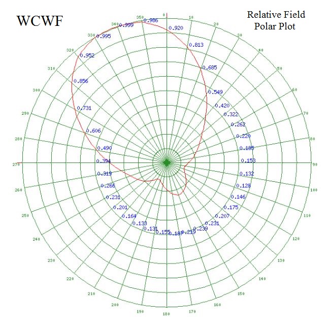

OR AS TVFOOL SAYS:
Please understand that this is a simulation and can only be treated as a rough approximation. Reception at your location is affected by many factors such as multipath, antenna gain, receiver sensitivity, buildings, and trees - which are not taken into account. Your mileage may vary.
Another difference I see is that because of transmitting antenna patterns WCWF only sends about 15 kW of its 800 kW Maximum ERP in your direction, but WACY sends 35 kW of its 50 kW Maximum ERP. See attachments 3 and 4 for relative field polar plots.
But, as you can see by the color code, you are on the fringe for both.
color code here:
http://www.tvfool.com/index.php?opti...id=15&Itemid=1
In very rough terms, the colors can be broken down as follows (not related to Antennaweb):
- White is extremely strong. Beware of signal overload on amps.
- Red-yellow-green are all quite strong. You can expect reasonable coverage with an indoor antenna.
- Cyan is where it's advisable to move the antenna up to the second floor or attic.
- Blue is where it's probably necessary to install a good antenna on the roof.
- Purple is quite weak and you really have to work at it for any chance of reception.
Anything useful here or are my posts tl;dr?

It's possible leaves from trees are blocking the signal from WCWF at this time of year. But normally I should at least see something from the televisions or either HDHomerun tuner at night. Currently there just isn't any signal to tune into at night. I hadn't payed close attention to the signal quality until earlier in August this summer. But I never experienced this last year of no signal over weak signal from last year.
So unless I'm told otherwise, I don't need to take down the J-arm and really need to consider trying another pre-amp before making the effort to redo everything. If all else fails, I will be content if I can't receive my local CW station as Hulu created and is offering add free service as of today.
