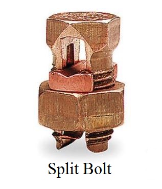

As an alternative, you can leave the Bell wire in place, scrape some black insulation off the Bell wire, and attach your new ground wire to the bare section of Bell wire with a split bolt.
they come in different sizes
http://www.homedepot.ca/product/8str...ge-of-2/910183
