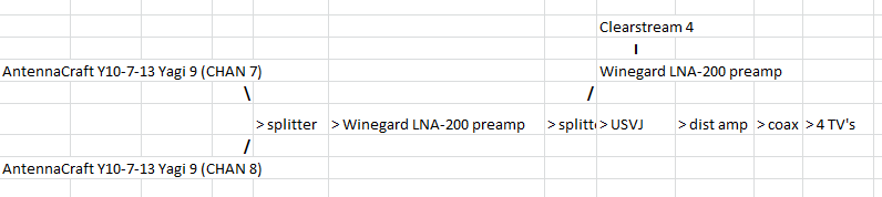

trying to post my skematics

Umm, your schematic looks a lot different than mine. Hold off on the changes until I've got it right.
First, I see that you have the 2 yagis connected to the input of the first LNA-200. How are you doing that? How can you insert two coax lines into one jack?
Second, why is there a splitter between the first LNA-200 and the UVSJ? A splitter is used to divide one coax line into two or combine two lines into one. A UVSJ is a UHF-VHF Separator-Joiner, used to combine a VHF antenna with a UHF antenna.
Third, where are the power inserters for the two LNA-200s?

Oops, I forgot to include the splitter in front of the preamp.

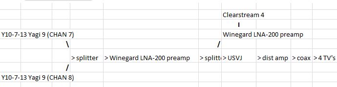

Smile
updated skematics

That is true about the first LNA-200 and the UVSJ. I did not know how to join the two VHF's with my UHF. Maybe I need tinlee to build a better joiner? I so love tinkering with my OTA. I love this old technology.

Old 18-Jul-2015, 10:46 PM   #12
OK, that makes more sense with the splitter used as a combiner for the two yagis. That's what I was worried about. The two yagis might be interfering with each, that's why I wanted you to eliminate the CH 8 yagi for the test by connecting only the CH 7 yagi to the first LNA-200. I wanted you to do that to see if a custom AC7 combiner from TIn Lee would be worth the expense.
Now, before you make any changes to your system, please show me how you are getting power to the LNA-200s.

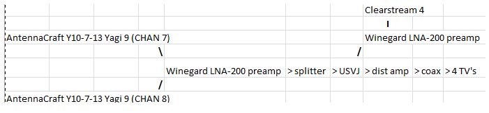

Old 19-Jul-2015, 12:06 AM   #14
Do I have it right now?

If I have it right, disconnect the CH 8 yagi and connect the CH 7 yagi directly to the VHF LNA to see how CH7 does; it's your weakest signal.
What UVSJ are you using; what does it say on it?
What distribution amp are you using?
I don't see any advantage of using two LNA-200s. You could use just one to amplify UHF and VHF.

Using an antennas direct 8 way dist amp and the splitters are passive. A wingard brand.
Yes, you have my skematics right.
