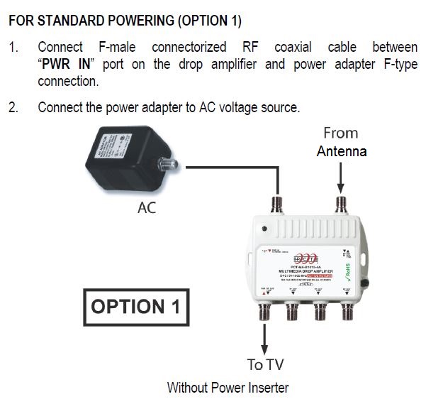

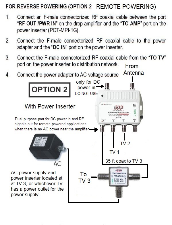

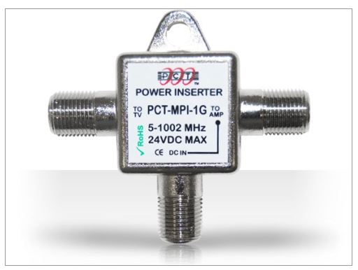

Remote power the distribution amp. It's easy, all you need is the accessory power inserter.

If you need the amp it can be remotely powered something like this, which was for another situation:

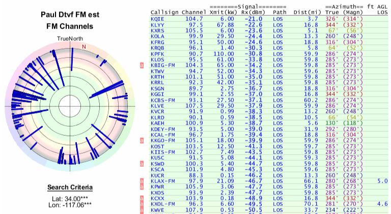

You have some strong local FM signals that might be a problem. Add an FM filter. See attachment 4 for an approx. report. You can run your own report here with your exact address:
http://www.fmfool.com/
FM reports don't link like TVFOOL reports.
