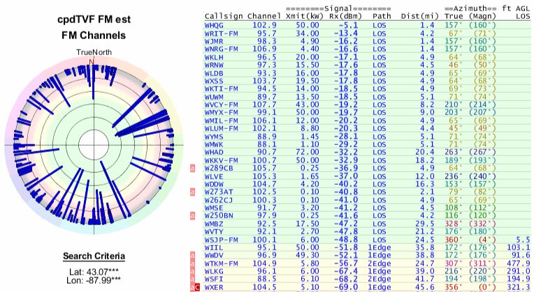

I also see that you have some strong local FM signals that might interfere with TV reception. See attachment 2. You should insert an FM filter in the coax line.

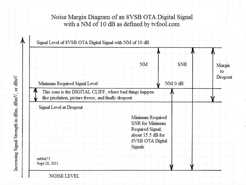

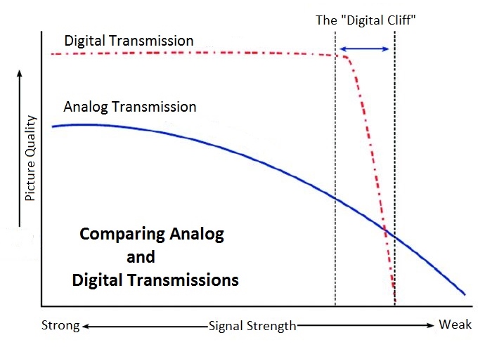

I read that the green pixelation and lag meant I was right on the cusp of good reception.
We call it the "Digital Cliff."
I read (and it may be inaccurate), that DTV signals are really either on or off
Correct.
