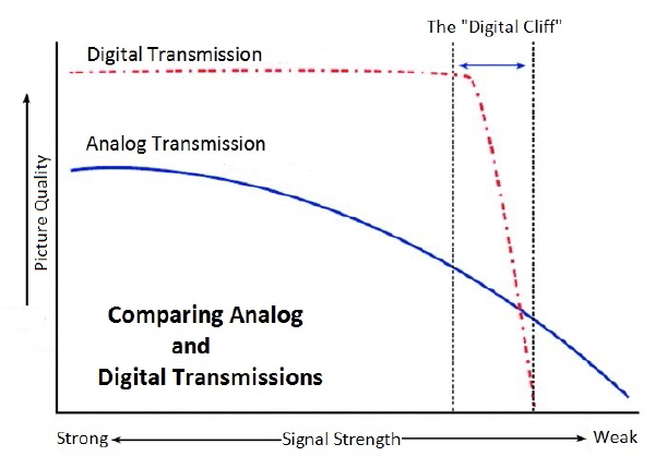

With digital signals it's pretty much you get it or you don't. The signal strength numbers are relative. What we don't know is how close they are to the "Digital Cliff" where you get pixilation, picture freeze, and finally dropout. You can see how much margin you have before disaster by inserting an attenuator in the coax to find out what the lowest numbers are before you have problems.
If you have a lot of margin before disaster, you don't need a preamp. If you are close to the digital cliff, a preamp would help.

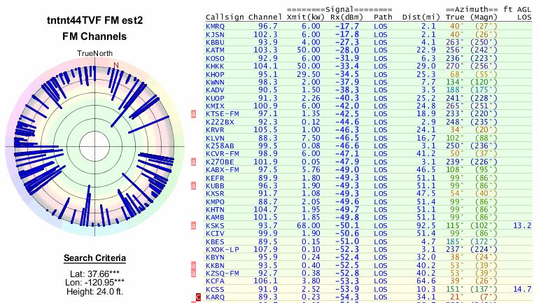

I see a possible problem; you have some strong local FM signals that might interfere with TV reception, especially with the C5 VHF-High signals 10 and 9 for ABC and PBS. You need an FM filter. See attachment 2.

The FM filters to consider:
http://comingsoon.radioshack.com/rad...l#.VZmnhTjbJLMvery slow link
