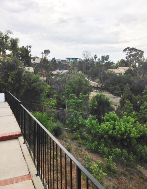

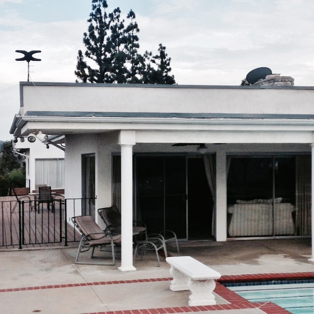

I have just posted two picts one in the antenna and the other is from below the antenna showing its path. The second pict is 15 feet below the antenna. Also not (not easy to see) but there is power wires feeding the house below me.

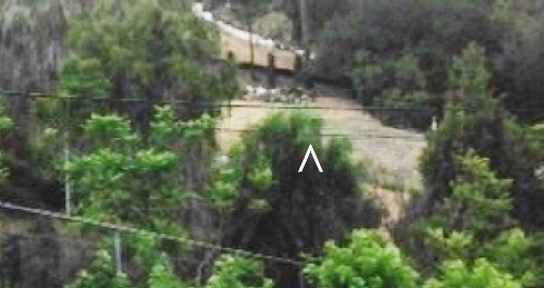

Thanks for the photos; they help. I adjusted the exposure a bit. Hope you don't mind.
If this view is 15 ft lower than the antenna, I think you are OK:
If that tree is in the 319 degree magnetic signal path, you need to move the antenna:
If the power lines are just above the arrow, I think you are OK unless they are radiating power line noise which affects weak VHF-High signals.

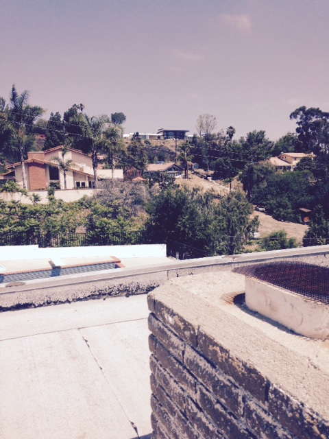

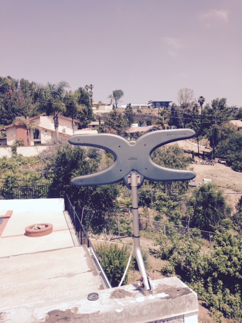

Sorry for the delayed response, I wanted to get up on the roof and take another pict to show you the actual direction. That big tree is the opposite direction behind where it is aimed.
I took another picture which is directly behind the antenna on the same horizontal height to try and give you a much better visual of what the antenna is pointing towards. I had to make them smaller to upload.
I could move the antenna to the chimney which is the second picture but it won't buy me much height than a couple feet. Plus then the wires are higher that the other current location since the wires are going downhill.
The TV is in the room right below the antenna with maybe 40 feet of cable and no splitters etc. I wanted to put it on the other end of the house which would be better, but that would increase the cable length by a lot and that concerned me.
I think the solution is a much better antenna so I am going to do some surfing and read up on the one you recommended. Maybe I should get a VHF one and use a switch depending on the channel?

Thanks for the new photos.
The 7697 covers VHF real channels 7-13 and UHF real channels 14-51 for 319 degrees magnetic.
You don't need a separate VHF antenna unless you want it aimed at 143 magnetic for real channels 8 CBS and 10 ABC.
When you mount the preamp near the antenna, it makes the signals stronger before the coax loss; you might be OK. You need to make some tests.
