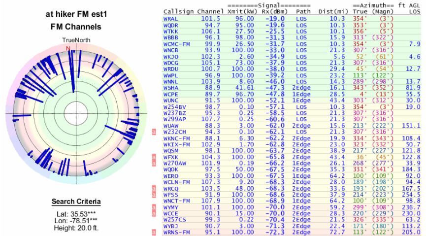

You have some very strong FM signals in your area, and you might need an FM trap/filter to prevent interference to your TV reception. See Attachment 3 for your location estimated from your tvfool report. Attachment 4 is based on Clayton.

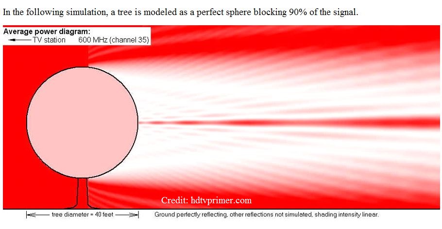

My advice is based on no trees or buildings in the signal path. Trees really mess with UHF signals. See Attachment 2.
