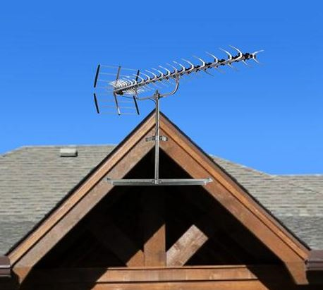

I really don't want to poke holes in my metal roof so could I use one of those gable end brackets that screw into the fascia? Anyone have experience with those? Do they hold up in wind?
They are OK for small antennas, but the large antenna/antennas that you need would be too much for them. You could run the mast down to the ground, and have the gable mount hold it at the top.
The VHF (7-13)/UHF combo to consider is the Winegard HD7698P. For UHF (real channel 14-51) only in another direction consider the Antennas Direct 91XG or DB8e. Combining antennas is a little tricky. A VHF with a UHF is easy with a UVSJ. Combining two UHF antennas doesn't always work.
You could use a rotator, but who wants to wait while it swings around, and who wants to repair it in the middle of January?
If you need to have more than one antenna, you can use an A/B switch for instant change of direction.

What would be some antenna options for me?
For VHF (real channels 7-13) and UHF (14-51), the Winegard HD7698P.
For UHF, the Antennas Direct 91XG or DB8e.
Mounts in attachments.

Still deciding on the mounting technique. I have a steel roof and really hope to not put holes on the top of it. So I was thinking about the gable end fascia board mount but I am worried about weight and torque from the wind grabbing the antenna and damaging things. Not to mention I still haven't decided which antenna I am going to try.
So....what are some other options for mounting? Is a tower an option? Where can you buy a tower?
