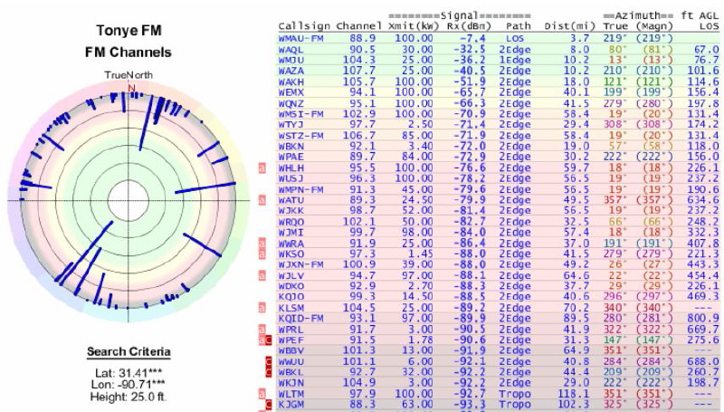

Welcome to the forum, Tonye:
These are tvfool reports at different heights using your coordinates:

I would suggest a Winegard HD7698P antenna and an Antennas Direct Juice preamp. You would also need an FM trap/filter to weaken the very strong WMAU-FM:

Yes, if you mean FM Band Rejection Filter. The FM trap/filter is to weaken WMAU-FM which is, at -7.4 dBm signal strength, a threat to the reception of CBS on channel 12. The Juice preamp does not have an internal FM filter, so you would need to add one or two in series with the CH 18 bandstop filter between the antenna and the input to the preamp.

Some other preamps do have an internal FM band rejection filter, like the CM 7778, but they are probably not as resistant to overload as the Juice.
A good alternative to an FM band rejection filter is a HLSJ (VHF-High-VHF-Low-Separator-Joiner) which attenuates everything below CH 7, including the FM band, by 25 dB. It has a low insertion loss because it uses a high-pass filter between the high and common ports.

Yes, do include an FM filter. The Juice likely won't overload, but your tuner probably will.
