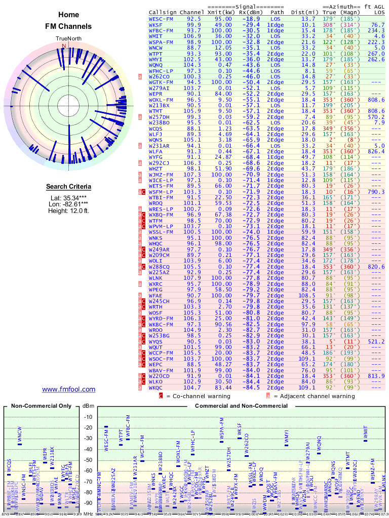

Old 9-Jun-2015, 4:54 PM   #16
lrkuta
Join Date: Mar 2015
Posts: 21
Attached is my FMfool image;
lrkuta is offline   Reply With Quote
Old 9-Jun-2015, 7:40 PM   #17
Originally Posted by lrkuta View Post
Thanks for the reply.
Can you elaborate on what type of FM filter and why you think this will help.
If you still have any Radio Shack stores nearby still open, a 15-0024. Otherwise, our FM filter on our web site. Call customer service and see if they can hook you up with one.
Why? Because I've done this enough to have learned (often the hard way) about what's usually most likely to help. Besides, a spectrum analyzer is a lot more expensive so it's worth spending a few minutes or bucks on something inexpensive that has a good chance of working.
