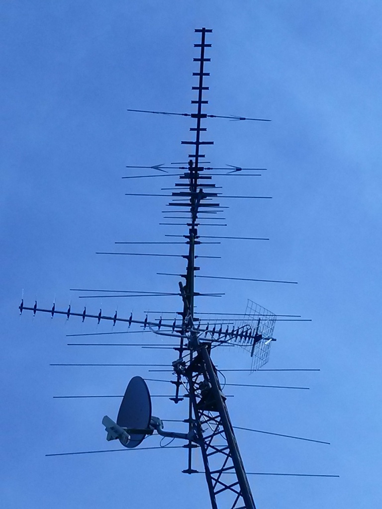

Now for my question. I installed the 91xg, but left the CA8100 completely operational. and I installed the 91 xg 80 degrees off where when it is pointed at 45 degrees, the CA8100 is pointed at 342 degrees. I am thinking I would like to hook both antennas with their pre-amps into the main cable that feeds my TV's. Do I need a special "TEE" to do this? Also, is there a problem with what I want to do? I want to do this so we dont have to turn the rotor to watch either set of stations from 45 or 342.
Well I think I gave you all the information you need, if not, I will answer your questions as they come. Here is a picture of my antennas. BTW, that dish is for wireless internet.

The 'tee' you're looking for is simply a standard passive 2-way signal splitter. When connected in reverse, it can act as a signal combiner. The problem most folks run into when trying this is that both antennas will receive some signal from directions other than to direction they're aimed at. When combined, the desired signal from one antenna may be aided by the other antenna... But only if the signals from each antenna arrive at or nearly in phase. If the signals are out of phase, then the net effect is a form of interference. You can try adjusting cable length on one of the lines between an antenna and the combiner... This alters the phase of all signals arriving at the combiner.
The bottom line is that it's a relatively inexpensive experiment that usually provides an unpredictable set of mixed results. Some signals will be fine while others are less reliable. Most folks end up with a spare 2-way splitter when they've given up trying to find a perfect combination of aim and coax jumper length(s).

The VHF performance of the 91XG is quite poor relative to it's excellent UHF capability. In weak signal conditions such as yours, the 91XG can't be expected to offer reliable reception of any real channel ranging from CH-2 to CH-13.
The CA8100 on the other-hand, is quite capable in the real channel 2 through 13 range. Have you considered pointing the CA8100 at 142° magnetic? Reception of real CH-11 should be fairly easy for the CA8100. Presuming that's successful, point the XG91 at 346° magnetic to receive the UHF (real CH-14 and up) signals. Combine the two antennas using a UHF/VHF combiner. The UHF capability of the CA8100 would be blocked by the filters at the VHF input port on the combiner and any VHF signal sneaking in via the 91XG would be stopped by the filters on the UHF port of the combiner.

I agree with everything you say, but i have 1 arguement. I have read that the 91xg can pickup the higher vhf bands, but is not rated for them. I can vouch for this as I am receiving ch 18.1 which is broadcast on ch 11. So if I can pulled 18.1 in, why cant I pull in one channel higher, 2.1 on 12? Also, I am pulling in 18.1 with the antenna pointed almost 180 degrees off of the direction 18.1 is broadcast from. SO accually right now I am able to get all the channels I want with just the 91xg, but I am sure the first time the conditions are not just right, I will loose 18.1, which is the channel I watch the most.
But what you suggested will be my solution, so thank you for that.

My 91XG can 'hear' some H-VHF... but the quality of the signal is quite compromised based on the signal measurement capability that's available to me (primarily the utilities that are provided with my SiliconDust HDHR tuners). An Antennacraft Y5713 is far more suited to H-VHF reception, but you would expect that, given it's designed specifically for that purpose. When you consider that there's a difference of 15 dB between the signal on real CH-11 and CH-12 and that the best of those two signals is roughly 30 dB lower than the nominal level a typical tuner is looking for, it's no surprise that the incidental VHF capability of a UHF only design can't deliver real CH-12 at your location.
Looking forward to your results... I'm expecting the CA8100 to provide far more success in the VHF band than any UHF only design can.
