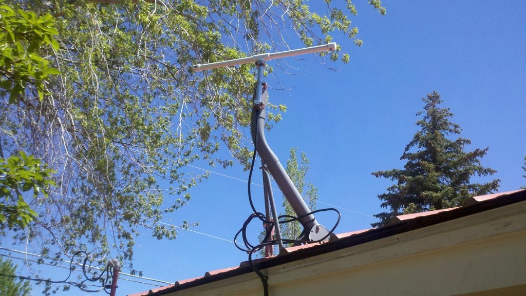

Through trial and error, I built the folded-dipole antenna in the thumbnail. Don't laugh. It gives me very good results (See attached table).

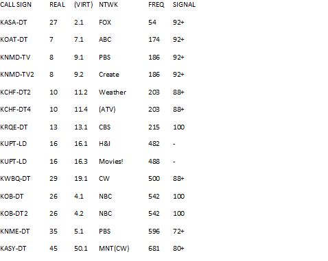

My question is about the two in the middle: KUPT*
Will an amplifier bring those in?

Oh! That's quite a nice TVFR. Do have a clear aim to the horizon at compass 190? Very few stations on your report are not at that heading, and almost all of those are impossibly weak. And one KCHF is strong enough that you won't need to aim at it.
A modest antenna like the Antennacraft HBU22 pointed at 190 should pick up all the stations down to KYNM except for K46GY. KUPT is quite strong, and you can probably receive it indoors with some well-aimed rabbit ears. Suspect your dipole isn't tuned that well...

I won't be surprised if my amateur attempt is poorly tuned, but the table I attached still perplexes me. I can't get my brain wrapped around what's going on between 482 and 488 MHz.
Looking at the Antennacraft HBU22 now. For that small of an investment, the folded dipole wasn't worth my labor. But it *IS* practically bullet proof.

Re your table, KUPT is the lowest power of those that you list, by 6 dB. This is a logarithmic scale, where each 3 dB is a doubling in power. Not really so mysterious.
And I'm not sure where you got different frequencies for 16.1 and 16.3. There's only a single bit stream for each real channel, as I understand it. The virtual channels are multiplexed in that single stream of bits. http://en.wikipedia.org/wiki/Digital_television The broadcast frequency is the analog carrier for the digital stream. The tuner locks on to the carrier - either you get a lock and see TV, or you don't, typically.

More vertical distance between the roof and the antenna may help. Electrical coupling to the roof could be an issue.
Stay far far away from that electric service mast.

Good eye! It's about 60' away.
When I was testing/adjusting/testing the dipole, one of the checks was the height above the ProPanel - in 6" increments (pipe nipples :-) Where it sits is where the signals strengths were best. I'm guessing the ProPanel is acting as a ground plane.
My bad. I was referring to the video carrier, ATSC pilot, and audio carrier frequencies.
