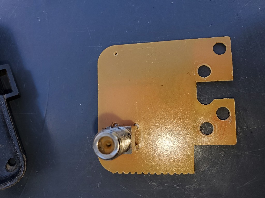

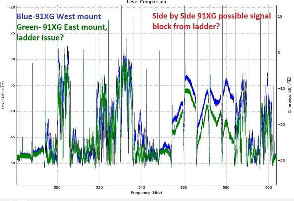

Seeing how we're on the subject of 91XG's, though it was a couple years ago I am experiencing an anomaly.
My original XG was on the mast for 4 years without the water relief holes drilled.
I brought it down to repair the reflector I decided to try some DXing and to pair it with another 91 XG. But first, I decided to test them separately and I'm glad I did.
At first I thought it was a ladder blocking signal under the right side so I moved them over to my other mast. Yes, there is still a ladder under the antennas. This one is much lower under the array and more equal between the two antennas.
There's quite a difference in signal strength between what should be equal signals.

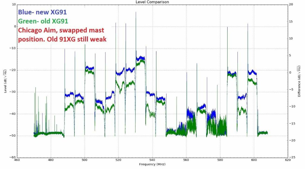

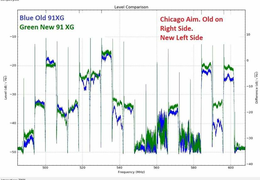

Some updated testing results.
I tested my older XG91 vs. my HDB91X. I wish I would have compared it to my newer XG 91.
File Type: jpg FB_IMG_1589165687917_copy_1024x709.jpg (107.7 KB, 3092 views)
File Type: jpg FB_IMG_1589165702022_copy_1024x700.jpg (151.8 KB, 3042 views)
File Type: jpg FB_IMG_1589301889396_copy_1024x700.jpg (140.0 KB, 3095 views)

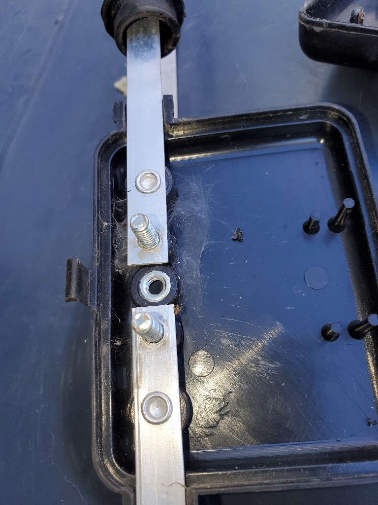

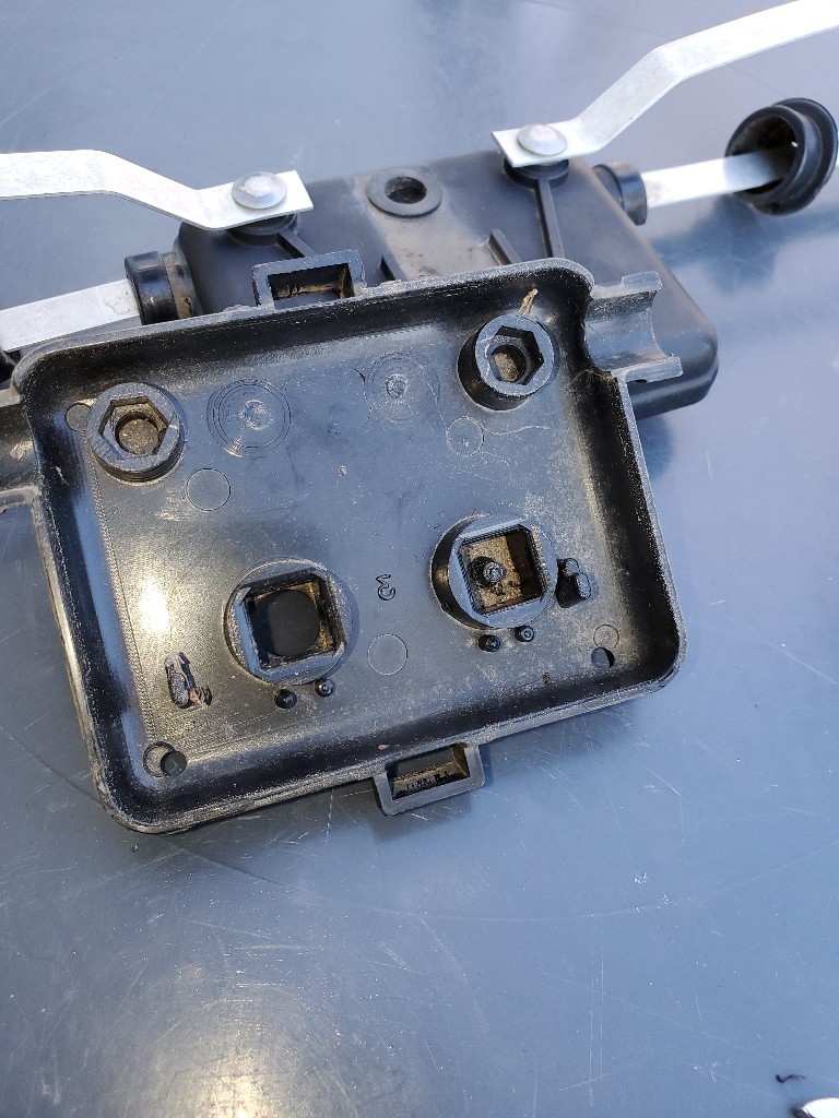

Balun Photo
Balun photos... at first they didn't show, do they show now?

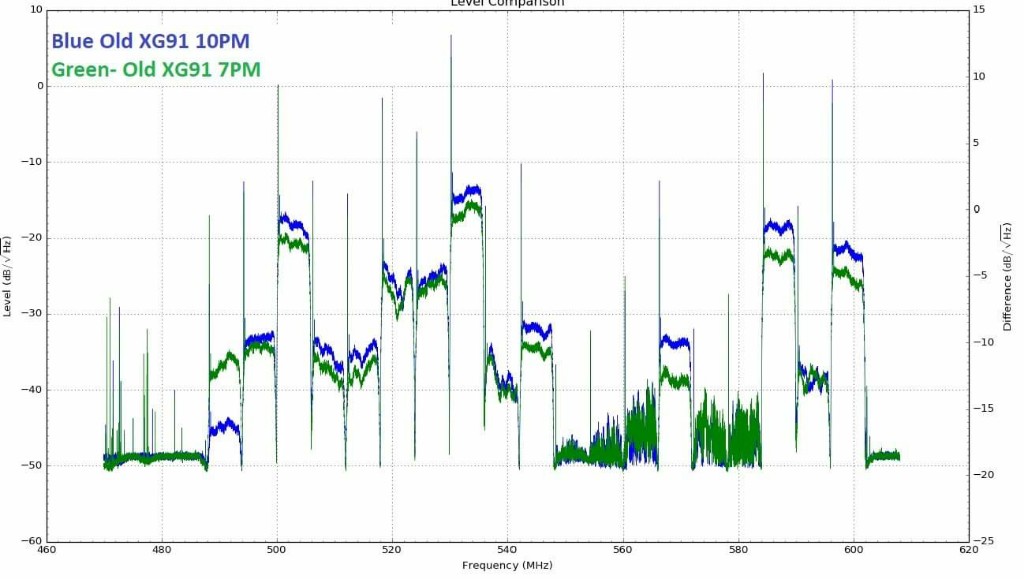

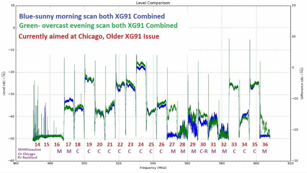

Spectrograms old 91XG versus new 91XG
So, Just for the hell of it, I combined the two and scanned. Later I came home and rescanned. So, having two unevenly matched antenna is detrimental, and it appears that a clear sunny sky is better than overcast.
Just before sunset, I scanned the UHF spectrum and then a few hours later I scanned again:
New Vs. old yesterday:
File Type: jpeg received_238310174268407_copy_1024x577.jpeg (111.5 KB, 4717 views)
File Type: jpeg received_657349698442756_copy_1024x579.jpeg (91.9 KB, 4689 views)
File Type: jpeg received_265394248179985_copy_1024x568.jpeg (97.8 KB, 4630 views)

Funny that this thread resurrected itself. To follow up on my original post, I received the new balun from Antennas Direct in Jan 2015, but never got around to installing it. The water intrusion in the old balun evidently dried up while the balun was being shipped and I had no more problems...until this spring. We had a lot of rain this spring and the problem resurfaced...I've had really crappy UHF signals for over a month now. I have the new balun assy still sitting on a shelf in my office, so now I just need to work up the energy to pull down the antenna and install it. I just hate dealing with ladders, roofs and heights in general...anything more than three feet off the ground makes me queasy...

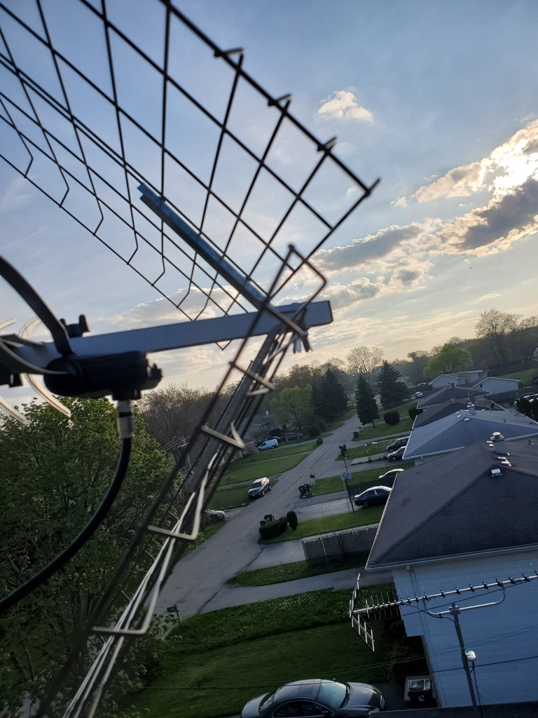

I resurrected the thread simply because I hate to see a bunch of different threads about the same subject. So, you never got around to putting the other one up? I wondered what happened. But I know what you mean, if it ain't broke you don't have to fix it.
Antennas Direct has agreed to send me another balun, which is very cool. As soon as it comes in, I'll put it on my old antenna and see what happens and report back.

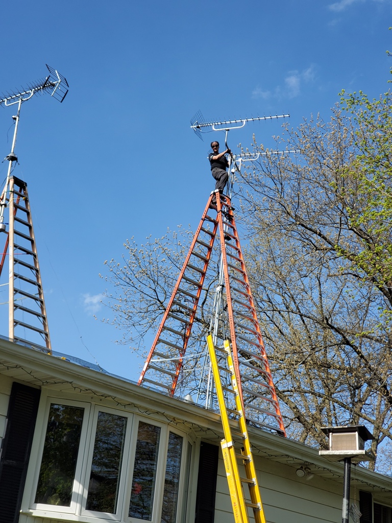

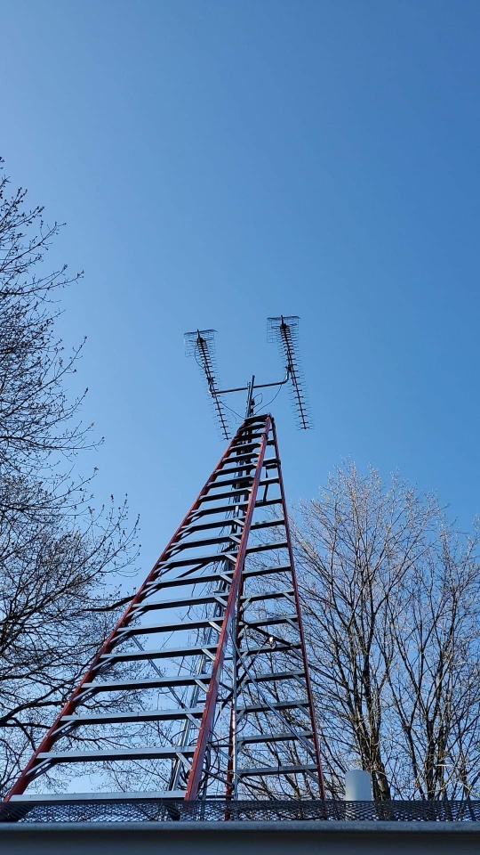

I've overcome my fear of heights lately when I bought a 22 foot step ladder and put it up on my roof. I know my neighbors think I'm nuts.

Oh my gosh! I get woozy just looking at that photo!

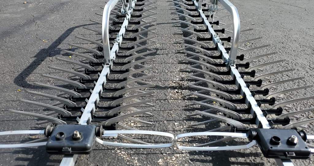

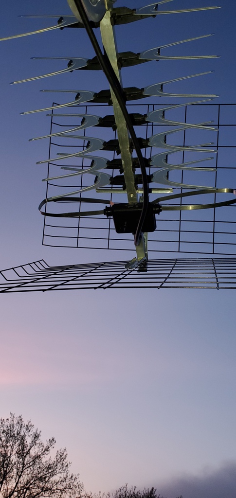

Two 91 XGs different results. Baffled!
[B][SIZE="3"]Well, I got the brand new Balun from Antennas Direct yesterday. No change, the patterns were about the same. I swapped coax cables no change. I put the old 91XG balun on the new 91XG and that didn't change. I even swapped the reflectors.
The reflectors are somewhat flimsy and even the new ones seemed to be bent. Still didn't make a difference.
When I assembled the new 91 XG next to the old one they appeared perfectly the same. The directors are reversible, but I use them in the hi performance mode. On this particular set of reflectors I noticed some misalignment.
Just for fun and nothing better to do, I scanned the two Antennas combined and came back a few hours later and rescanned, just to prove the signals do change in strength:

By the way, that photo of you standing on top of the very tall stepladder on top of your roof just scares the crap out of me! I almost got dizzy and fell out of my office chair while looking at it!
I'm surprised that those pictures do that to you, but they can. I have a weird fear of heights myself. I can go up in the tallest buildings in the world just fine but looking down makes my legs buckle. They have a glass floor in the CN Tower. I was scared to walk across it. They now have one in the Willis (Sears) Tower and lean out windows in the John Hancock building both in Chicago.
