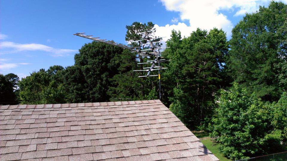

I am currently running a Winegard HD9095P antenna aimed at about 235 degrees with a Winegard HDP-269 preamp mounted at about 10' above the house (picture is a 5' mast, I have doubled the height since taken), approximately 30-35 off ground.

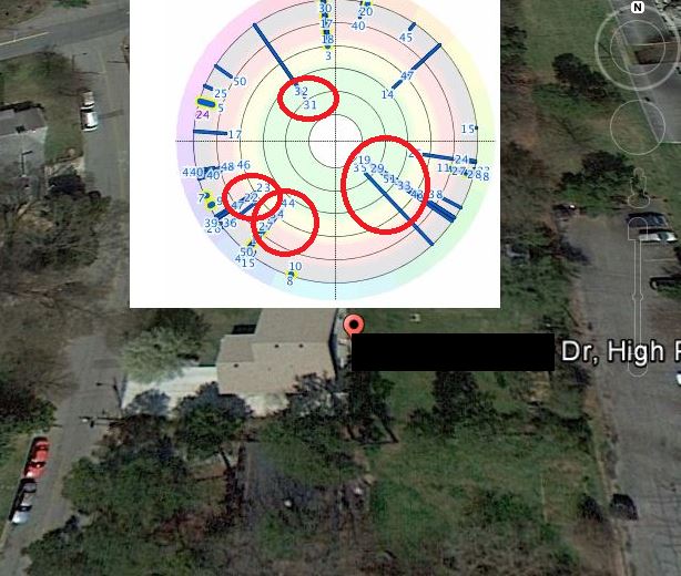

Here is my TV Fool Report http://www.tvfool.com/?option=com_wr...d243dea874aeef
I currently have issues with reception on all FOX channels. 8.1, 46.1 are weak if I even get them. I would like to fix this asap with football season approaching.
My antenna is pointed toward Charlotte, and I pick up most of the channels in that direction. To give a an idea on the degree range I am picking up, 2.1, 12.1, 58.1

I have a clear shot at the sky. I have a 10' mast ( picture is a 5' mast, I have doubled the height since taken) and could space the antennas a few feet apart.

I did a ton or research, got feedback on other forums, and I concluded, if done properly, this would work. So I went for it. My conclusion was correct. I am currently picking up channels in both directions, clear as day. Counting sub channels, I am picking up 36 clear channels. I have another 6 or so that come in and out. I am reaching as far out as 76.3 miles without decline in signal quality.
Attached is a picture of the setup as well as channels I am receiving. One antenna is pointed at 246 degrees, the other at 133 degrees.
