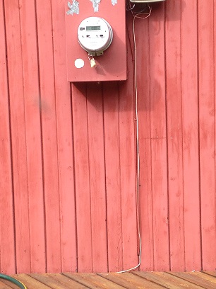

Thanks very much for the detailed answers. So i've been considering how to ground my antenna based on the info provided and i'm a little bit stumped. I would have to run my coax and copper wire around the side of the house to the front where my service panel is located (meaning under the front deck as well which is quite low to the ground in many parts so quite difficult). 1) is this safe? Seems scary to think i'd have a potentially charged copper wire running all long the side of the house, most likely touching the wood exterior where it meets the foundation all the way to the front of the house? and 2) ive attached two pictures. The first picture is the service panel on the front of the house from the outside. You'll see the box and below it there is nothing except the deck several feet below. The 2nd pic is what it looks like below the deck (directly below the panel). It would seem as though i dont have access to the grounding setup. The middle cable coming out from the deck runs approx 10 feet away from the house and disappears into the ground so i assume thats the grounding cable. From the inside i can see all the electric cables disappear into the wall right below the panel and are partially spray foamed over (the basement is only about 4 feet high and unfinished). Is this a typical way to ground a service panel? Would it make sense to lead a cooper wire from behind the house, all long the side of the house, under the front deck just to reach the visible grounding cable that is seen in Pic 2? if so, would i just wrap the copper wire to the grounding cable? Any ideas would be great. Thanks

The chance of the #6 bonding conductor becoming energized is much lower than that of the isolated ground rod and any parts connected to it. (Provided the connections to the existing electrical service ground are made securely, using connectors that are appropriate and the cables are prepped to remove corrosion and other sources of resistance.)
The goal is to minimize resistance/impedance between the two points being 'bonded'. If you use soil instead of copper, the resistance will be much higher, and quite variable. If you use wire that is too small, it may fail while conducting fault current. If you allow corrosion to remain in a connection, or use a connector that corrodes, you can expect the 'bonding' connection to fail... allowing a voltage difference to exist between parts that should be at the same voltage level.
I would verify that the heavy cable shown in the photo under your deck is the grounding conductor of your electrical service. If so, I believe that a split bolt connector such as this, http://www.homedepot.com/p/Blackburn...B1-5/100125660 would be a secure means to join new #6 AWG to the existing. I would not rely on twisting or wrapping.
If the underside of the deck is inaccessible, there are connectors that can securely connect to the meter-base... which is also a legitimate point of electrical service ground. I would consult with an electrician if that was the route you needed to go.
