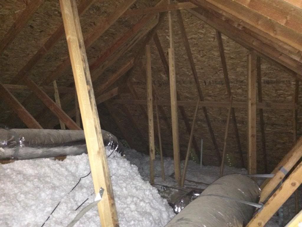

Thanks. I checked address specific and no major changes. Most broadcasts come from the south. In the attic on south side the roof comes all the way down the wall with stabdard asphalt shingles . Would that pose a problem? I have a window in my attic and a section above my garage with siding type material, but it faces north. Thanks

Asphalt shingles, tar paper and wood are usually not too much a problem. Metal flashing, gutters, foil layers on insulation, duct work and pipes are all great at reflecting and blocking signals. Stucco reinforcing wire and mesh is a very effective signal barrier also.

Atics and the inside of buildings Are Not a reception friendly environment and Never Will Be a reception friendly environment.
Start with a , http://www.antennacraft.net ,
HBU11K antenna in the attic aimed at about 174 degree magnetic compass direction.
Use a Real and Actual magnetic compass to aim antenna.
If reception situations/problems happen in the attic that are not resolvable with antenna aim and location adjustments in the attic.
Then move the HBU11K antenna to above the roof in such a manner that the roof and building are not , obstructing , impeding , blocking , reception inthe directions of , South West , South , South East , North , North East.
A antenna system amplifier will most likely not be required.

I should have plenty of room to get above all duct work, etc. too

Just an update. With a cheap indoor $10 rca antenna I was able to get a few channels but not much. Shows cut in and out. With the ant 751 in the attic I am pulling tons of channels on 2 Tvs with no issues at all.
