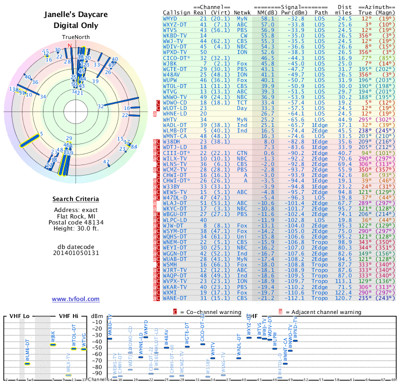

I'm missing my Toledo programming I used to get from my old house, Checking the plots, most TV stations within easy reach are in two distinct directions, Aprox 19 degrees, and 200 degrees, all within 40 miles or so.

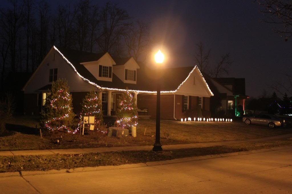

I'm going with an eave/gable mount, with a mast up to 10 ft tall, hopefully much shorter, I'd like to keep it under 4 ft above roof level if possible. I have a two story and the antenna should have a height of around 25-30 ft (maybe slightly more) once mounted. See my silly Christmas light picture, it would be at the end of the house (left in pic) where the antenna will be mounted. This side of the house is where all the other utilities pass through, and will offer the cleanest install.

I plan to put it on the West side of the house, the side gable to left in pic.

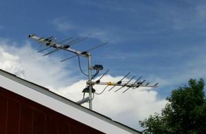

If I go with twin ANT751s, is there any issues mounting them back-to-back like this?

Install 1 Antenna.
Directional antennas such as and not limited to the ANT751 antenna receive the best in the , forward direction , a little less at front angles to the antenna , less at back angles to the antenna , less at the back of the antenna.
Directional antennas such as and not limited to the ANT751 antenna receive the least amount of signal directly on the sides of the antenna.
Small directional antennas such as and not limited to the ANT751 antenna have a small amount of signal gain at the front of the antenna and also receive at angles to the antenna.
The bigger larger and more reception elements a directional antenna has , the more signal collecting ability the directional antenna has and receives more signal at the front of the antenna.
And directional antennas also receive at angles to the antenna.
Most of the signal strengths are strong at your reception location.
--->Instal and connect 1 ANT751 antenna <--> Above the Peak of the roof in such a manner that reception is not , obstructed , impeded , blocked , by the roof and building in All directions.
Aim the ANT751 antenna at about 30 degrees magnetic compass direction.
