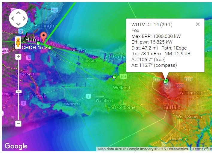

Thanks for confirming why I can't get WUTV FOX 29! I'm on East Mountain and for the life of me I can't get WUTV but I get WNED (real 43) perfectly even though they are broadcasting from very similar locations. THE CHCH tower in Stoney Creek is (15 real) is right in the middle of the signal from WUTV (14 real). I was suspecting interference from CTV in Kitchener (13 real) but it's probably CHCH that's the culprit.
Ironic my friend that lives down the mountain (~4km north of me) and should have the escarpment blocking his signal gets WUTV all the time.
I know this is an old thread but has anyone on Hamilton Mountain found a solution to this?

Yes, it is CHCH on adjacent channel 15, which is 54.3 dB stronger causing interference. Max allowed is 33 dB stronger.
ATSC Recommended Practice:
5.4.2 Adjacent Channel Rejection
The receiver should meet or exceed the thresholds given in Table 5.2 for rejection of first adjacent-channel interference at the desired signal levels shown above the columns therein.
No, not 13, it is a VHF-High channel, not UHF.
Since your antenna is facing CHCH when it is aimed at WUTV, you have a serious problem that might be impossible to fix, but I will try to give you a few ideas.
You can't use a preamp to make Fox stronger because it will be overloaded by your first 3 strong signals.
One possible solution might be to have a separate antenna for WUTV with a custom filter for WUTV from Tin Lee that would make CHCH weaker. I'm not even sure that they could design a custom single channel bandpass filter for WUTV. If they could, it would be expensive. You could talk to their engineer and email him your tvfool report.
WNED sends 156 kW of power your way:
http://www.tvfool.com/?option=com_wr...ALLTV%26n%3d13
but WUTV only sends about 17 kW of power your way because of its antenna directional pattern:
http://www.tvfool.com/?option=com_wr...ALLTV%26n%3d17

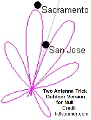

Another possibility would be making an antenna so directional that it would reject some of the CHCH signal when it is aimed at WUTV, because they are 10 degrees apart.
Another possibility that might work is the "Two Antenna Trick, Outdoor Version" as described on the hdtvprimer.com site. It is possible to connect two antennas so that WUTV would be at a main lobe peak and CHCH would be at a null:
Example 3: Cupertino, California 95015
The towers for Sacramento and San Jose are only 15 degrees apart, but the San Jose towers are visible on the horizon. Pointing an amplified high-gain antenna in this direction will cause both preamp overload and adjacent channel interference. Putting San Jose in a null will permit the reception of Sacramento. Set the masts 40 inches apart. Reversing the polarity of one antenna will cause the null direction to not change with frequency, and all the San Jose stations can sit in the null.
