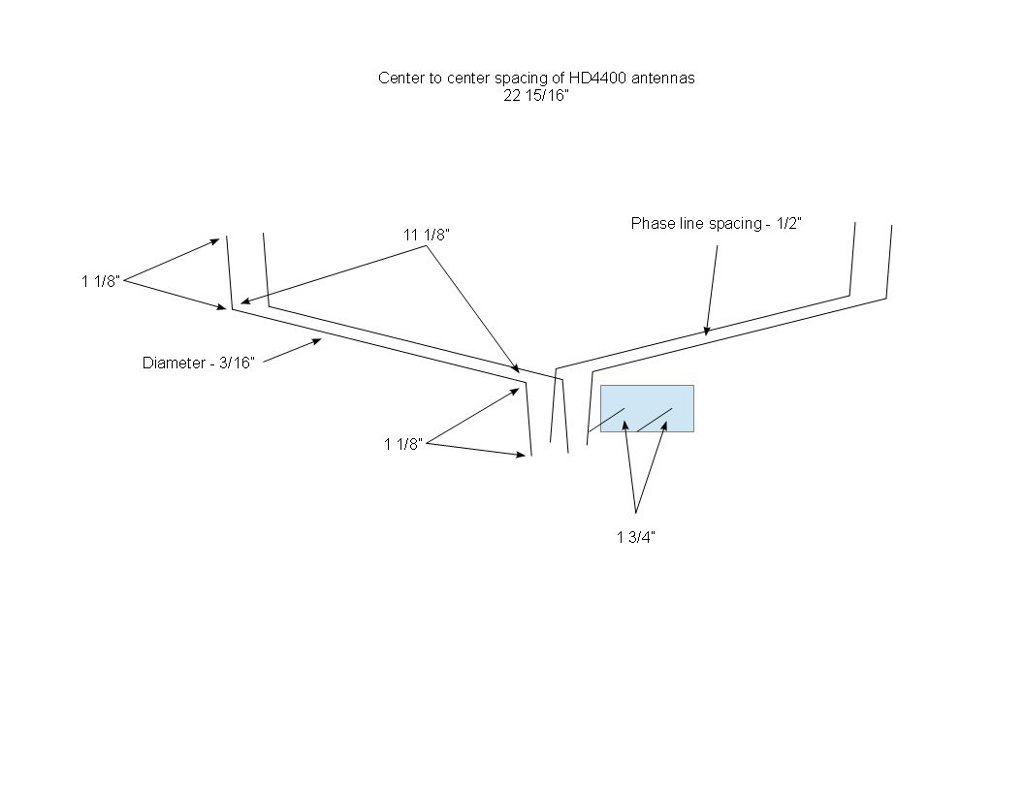

Start long, about 5.5" per 450Ω 1/4 wave section... experiment. Also start with each 300Ω link cut for about 1/2 wavelength in the middle of the band (around CH-33). Keep the twin lead stable... and both sides the same distance from metal. PVC pipe can be used to fabricate standoffs.
I have an HD8800 that's not in service at the moment. Give me a couple of days and I'll get some photos & dimensions of the combiner/phasing lines. They're just open parallel wire...

HD8800 phasing harness
Here is a drawing based on my HD8800...
File Type: jpg HD8800 combiner - phase lines - rev 1.jpg (29.7 KB, 3883 views)
