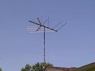

here is the picture.
Hi,
(first many thanks!)
Ive attached an image of the roof antenna.
Basically just want to watch channels 2 through 20, without alot of headache.
Again thank you.

er- (..funny, never really looked at the antenna until taking a picture of it)...
Are one of the elements (3rd of 4) bent upwards?
Also, am curious, do newer antennas have improved design? I am guessing the pictured antenna is 20yrs+. However, I've found "heavy-duty" aint what she used to be. If there's any improvement, its in the manufacturing ingenuity to build such shoddy crap that still somehow works long enough to leave the store shelf.
Anyhow, is the antenna damaged? Should I just try bending it straight?

Looks like some metal reception elements are bent and will break off as time goes by.
To avoid problems with reception.
I recommend replace the old antenna with HD850 antenna.
When installing the HD850 antenna on the mast pipe.
Is OK to install the HD850 lower on the mast pipe.
Lower means at about the same height as your head , as your are standing on the roof. This makes it easy to install the antenna.
