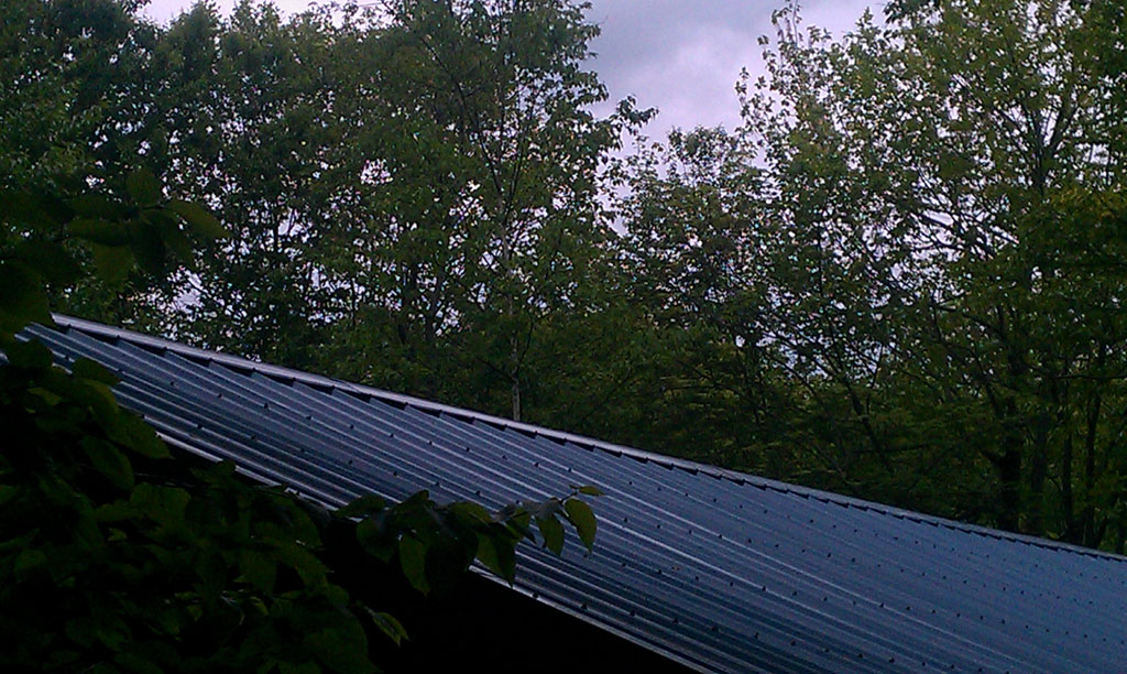

I live in the Green Mountains, of Vermont, north of the Berkshires, east of Albany on a west facing mountainside at just under 2000', in the forest, on a dirt road. Lots of snow drops here. I doesn't all melt off until May most years. The good news is, that the trees are bare more than half the year. They just filled out a couple weeks ago.
I cancelled my DirecTV after the two year contract ran out last month and they had raised my monthly again. I planned on doing without for the summer to spend more time outdoors. We had an evening at a neighbors house, and he has a 2 bay UHF antenna that he gets a lot with (something like 16 channels), similar to the Eagle Aspen Dtv2Buhf Directv 2-Bay Uhf Antenna. He is below my elevation, and below the trees.
So, I think I would like to mount something on the roof peak at the rear of the house that will face westerly toward the Albany area towers. I have attached a photo of the view F.Y.I. It is a challenge. Fortunately the most open area is toward the towers in the WSW direction.

Looks like too many extra steps to find location and antenna height above ground.
It is better to go to the tvfool home page , click on >>Start MAPS<< , move the pointer to your location and enter a antenna height above ground , if you can install the antenna 50 feet above ground , then Ok.
Please make 2 tvfool reports , 25 feet and 50 feet above ground.
Click on the Make Radar Map button.
Do not delete the tvfool report with extra steps.

Install a Winegard HD7084P All channel antenna above the the Peak of the Roof in such a manner that the roof and house are not blocking reception to the west south west.
Aim the HD7084P antenna at about 271 degree magnetic compass direction.
