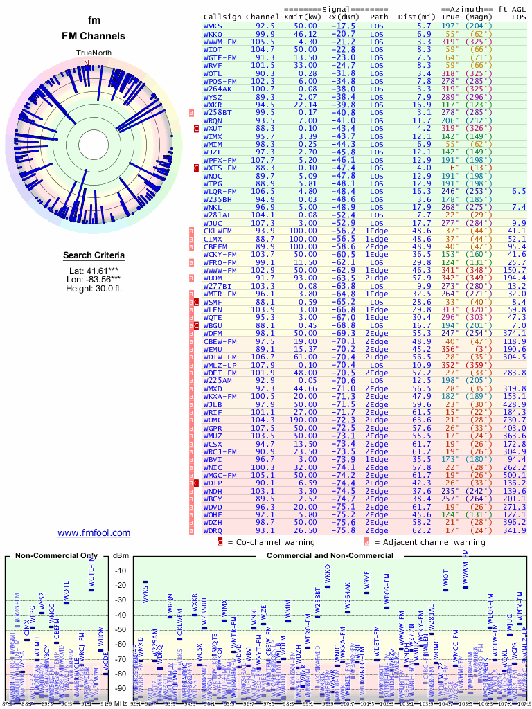

Hopefully this worked, I added an attachment of my FM signals.

An FM trap may be needed. Ex. The second harmonic of WKKO, 99.9 lands in the middle of real CH-11, WTOL.
I've not gone though every permutation...
