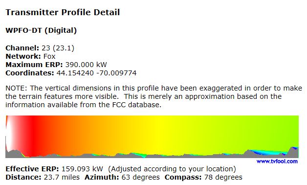

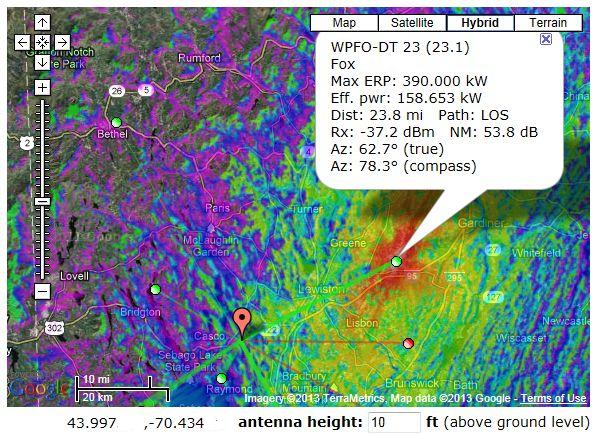

You may be on a hill but the coverage from FOX is very spotty at your location, and there are other hills in the signal path. It looks like they got the signal power and NM numbers reversed.
