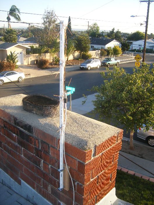

I am in San Diego and have a homemade antenna (attached pic). My antenna is mounted on top of my roof and I am in a pretty flat area. There are 2 local channels that I only get sometimes, I get all the other local channels fine except for these 2:
KFMB-TV (CBS) Distance: 12 miles @309° Channel 8.1
KGTV (ABC) Distance: 12 miles @309° Channel 10.1
Sometimes these 2 channels come in fine and sometimes not at all, even if I go up and the roof and adjust to all angles.
Is there anything that I can do to improve the performance of this or is there a better antenna type that I should be using?

FYI, the reason you're having trouble with these two stations is because they are broadcasting on VHF frequencies (ch 2-13). Be sure to look at the "real" channel being used by each station. Your antenna is designed for UHF frequencies only (ch 14-69).
If you want to do a better job picking up the VHF stations, you can either add a VHF-only antenna to your current setup, or you can switch your antenna to a "combo" antenna that does both VHF and UHF.
Some good high-VHF (ch 7-13) antennas are the Winegard YA-6713 and Antennacraft Y5713. Either of these antennas can be combined with your existing antenna using a Pico Macom UVSJ or equivalent (this is a diplexor, which more appropriate for this situation than a typical 2-way splitter/combiner).
Some good "combo" antennas are the Winegard HD7694P and Antennacraft HBU-33. Either of these would be a nice "one antenna" solution for your situation.

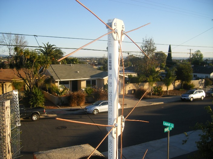

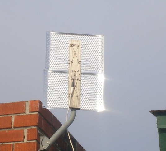

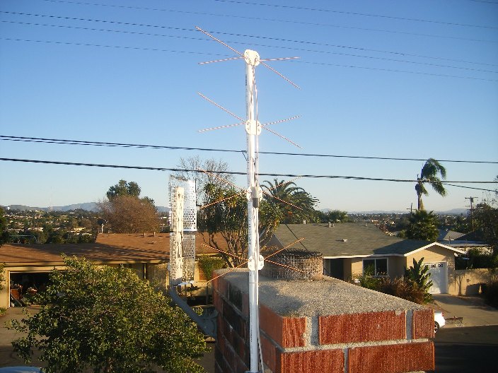

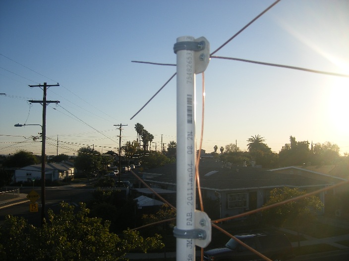

Hey guy's thank you all for your help, I got some plans from http://m4antenna.eastmasonvilleweather.com/index.html and made a new antenna and it working like a champ. I can now pick up the 2 channels that were not so good before and am getting another channel that I did not get at all before. I used # 10 copper wire mounted on PVC and all the connections are soldered. I made the 9 1/2" x 9" antenna. Here are some pics.

Wow you are doing very well. And all the connections are soldered , the conections will last a long time out in the weather. Having no reflector , the antenna receives 2 directions. As you have figured out by now , a reflector makes the antenna 1 directional and increases the reception in the 1 direction. And reduces reception from behind the reflector. The antenna with out the reflector receives from 2 directions and the antenna gain is less , but has the advantage of receiving 2 directions. Antennas work simlar to a light bulb. A bare light bulb sends out light all directions , a light with a reflector , reflects more of the light in one direction and this makes the light stronger.

The down side of a antenna with out a reflector is - multipath. . The advantage of digital Tv tuners is the multipath correction that corrects multipath up to a certain point. In the 'old days' of Analog Tv - multipath was a real problem , it showed up as ghosts in the picture. . The extra tv channels are likely arriving from other directions to your 2 directional antenna.

Here is how to point tv antennas. http://www.kyes.com/antenna/pointing/pointing.html , Read and understand this about Real Digital Tv Channels and Virtual Digital Tv Channels and Analog Channels. http://forum.tvfool.com/showthread.php?t=695 The 2 directional antenna can be directed between digital channels 19 / 28 and 8 / 26 and will receive most all of those channels in those 4 directions.
