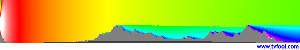

Click on KGO on your report, for example, and you will see that the signal is blocked by terrain. And as John has pointed out, KRNV is also transmitting on channel 7, the difference in signal levels is less than 20 dB... The deck is stacked against you getting reliable reception from the SF stations.

Actually, VHF channels like 7 bend over obstructions better than UHF channels do. Note that despite the lower transmitter power, it is predicted to be your strongest SF station. Click on any station in the table of your report to pop up the terrain profile af the path from transmitter (far left) to you (far right).
