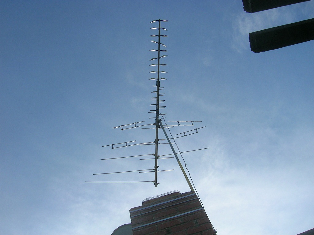

I realized there was an old outdoor antenna mounted on the chimney. The longest leg @ the right end of the antenna was lost (see attached pic).
I realigned the antenna's angle so to point to around 319° (true north).
I got almost every channel I needed,
except KGO (ABC Ch 7, 44.3 miles @ 319°, power -46.9dBm) where I got nothing. On the Channel Master CM-7000 it showed 0-20% signal during the day. No pic. Occasionally a picture came in, and soon it disappeared.
KGO is the only VHF channel I want right now (all other channels are on UHF as far as I am concerned).
http://www.tvfool.com/?option=com_wr...ALLTV%26n%3d15
** There were a few tall trees about a block away from the antenna along the line where the antenna pointed toward (319°). They were taller than the antenna. Not sure if they posed any obstruction.

Nice antenna... when it had all it's elements. Let's presume it has served well but needs to be retired along with the coax that has been with it in the weather for quite a few years.
You mentioned trees in your path... Let's be conservative and budget 10 dB of loss as a worst case. KTLN CH-47 was on your original priority list. I see a predicted NM of 24 dB. Subtract the path loss due to trees and you're down to 14 dB NM. Add the antenna gain of 7 dB (UHF section of an HBU-22 or HBU-33) and you are up to a 21 dB NM, (more than enough for a line of site path but adequate for an edge path). Now let's say you have a total of 60' of RG-6 between the antenna and the farthest receiver, (conservatively 5 dB of loss) and 8 dB of splitter loss. 21 - 13 = 8 That's not much wiggle room. Still, at the antenna you have a comfortable NM. If you install an HBU-22 aimed at KTLN (315° per your compass) you should easily get a reliable KTLN with no amplifier and no splitter.
If after adding a splitter, KTLN becomes unreliable, you can add a high input preamp such as a Winegard HDP-269. I've looked at the TV signals and see between 60,000 and 65,000 micro-volts of signal in the air (that does not include antenna gain), that will overload most preamplifiers but the HDP-269 is rated for 350,000 micro-volts input. There is still a chance you would need to add an FM trap ahead of the preamp given the strong local FM stations. (Read this to mean, "An amplifier is likely to have problems with overloading." and "Add an amplifier only if you have proven you need it.")
KGO is predicted to be 20 dB better to start with. Still, as insurance you could go with an HBU-33 for it's better VHF gain. Both the HBU-22 and 33 have fairly broad beam widths so they should easily see the stations to the NW all the way down into the yellow section of your report, also expect to see the stronger stations to the north.
After having said all that, I think a new antenna and coax will do you wonders.

1) I'm not confident that either the antenna or coax are serviceable at this point. Consider replacing the coax as the next step. (Standard RG-6 or RG-6/U, no need for quad-shield) That allows you to test with your indoor antenna on the roof if you choose. (you may need a 'barrel' connector.)
2) If you still don't see KGO, I'm with John on the recommendation regarding an FM trap. They are inexpensive and there is a real chance you will see KGO as a result.
There is more than enough signal in the air for a set of non amplified rabbit ears to receive an excellent signal from KGO provided there is minimal interference from FM or multipath.
The old roof top antenna is missing elements that will effect it's VHF performance, it's not a viable standard to use in judging signal conditions.
An HBU-33 is more than enough antenna based on gain, it's directivity may be needed though. By trying the two steps I've suggested, you can hold off spending money on a new antenna until you have more conclusive information to work with.

Thx much for all the suggestions. I definitely need to pick up the signals from an outdoor antenna due to the stucco walls the house has.
I am going to try moving the antenna a bit off-angle, and also getting an FM trap, to see if I can find enough improvement w/o getting a new outdoor antenna.
If the lost leg is causing the old outdoor antenna not able to pick up KGO and moving the antenna around/adding FM trap don't help, I'll get a replacement antenna as the next step.
The old RG59 coaxial cable goes way up on the existing antenna above the chimney, and replacing that cable requires pulling down the existing antenna -- I might as well get a new outdoor antenna and the coaxial cable at the same time.
