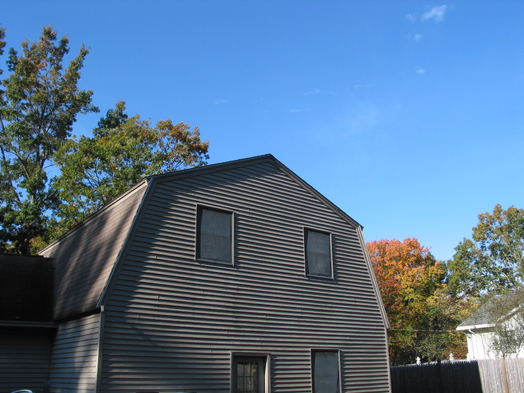

I attached a picture of my garage ridge mounting location. Thanks again.

3. I see a tree in the left hand side of the picture that is close to the house.
As has been stated , It is best to install the antenna at a location that has the least amount to no amount of obstructions of any type or kind in the directions of reception.
Do not install the antenna on the end of the house that is close to the tree if that tree is in one of the directions of reception that is shown in the left hand side of the picture.
You may recall this statement , As always trees and tree leaves do a real fine job of reducing or blocking reception and so do buildings and other obstructions.
What direction is tree in the left hand side of the picture??

The tree is approx 280 degrees west. No big deal... I understand that no conditions are perfect. I'll just try the antenna and see what I can get. Thanks again.
