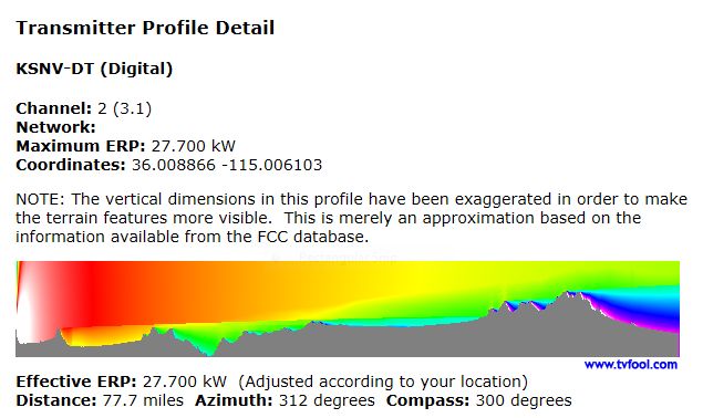

In terms of dBm, those noise floor figures would be about -59 dBm and -69 to -74 dBm respectivly, which is a lot stronger than your -87.1 dBm CH2 signal.
But, it certainly is worth a test in the attic as long as you have the antenna.
The KSNV profile doesn't look too promising, see attachment.
