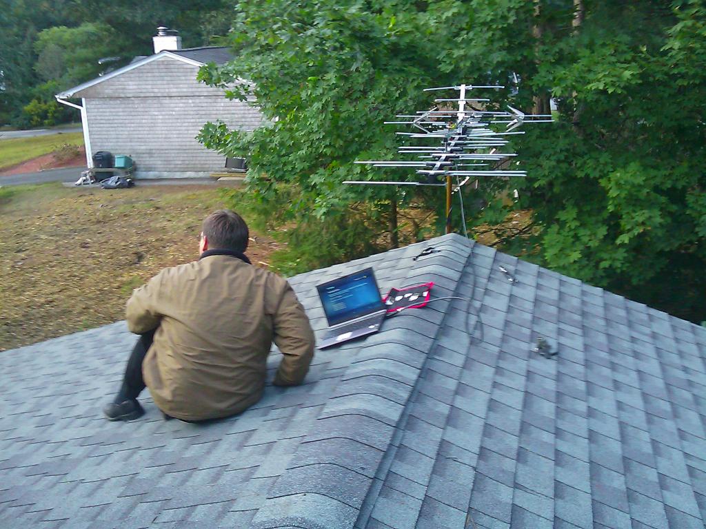

You might have to locate the laptop on the roof with you like kevm14:
http://www.avsforum.com/t/381623/the...#post_17280909 #11738
Kevin's image repeated in attachment in case the above post link or his image link is broken. The link for his photo is here:
http://kevinallenmoore.com/photo/d/81845-2/IMAG0054.jpg
Obviously, his main problem was trees in the signal path!

I was thinking laptop on the roof or maybe a tablet remoted to the laptop. It's a little more challenging than Kevin's since it's S-tile instead of flat shingle (a delicate balance of 1) don't drop the thing you're carrying, 2) don't break any tiles, 3) don't fall off the roof).

Awesome picture, too.
Yeah, Kevin didn't look safe up there.
Yes, I thought Kevin's photo was a lot of fun. Your situation reminded me of it, so I hunted for it in old posts to give you the link.
I wonder who took the picture?
