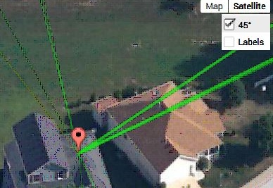

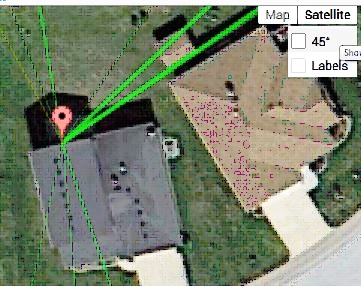

Earlier in this thread, post 26, I thought the problem was multipath reflections.
IF the problem is multipath, and IF a more directional VHF-hi antenna helps, then another alternative would be to replace the C2V with a UHF/VHF-hi combo antenna.
IIRC, the early TiVo tuners didn't handle multipath reflections very well.
https://www.google.com/?gws_rd=ssl#q=TiVo+tuner+doesn't+handle+multipath+very+well
Later, I was convinced that the problem was signals that were too strong, based on what other Roamio users had posted. Now, based on your attenuator tests, I'm back to multipath.
That metal stack in front of the C2V couldn't be doing much good for the signals from the NE. I also wonder if they can clear the roof of the house to the East of you. If not, it would cause diffraction and scattering of the signals.
Any chance you can raise the C2V a little higher on that mount to clear the stack for a test?
Your antennas are in a "valley" between the higher roof on the west side of your house, and the roof of the house to your east. It doesn't seem to bother the 91XG because it can look out the end of the valley to Fox. But, the C2V can't see the transmitters from the NE because of the house to your east. How high is your C2V in comparison to the peak of the roof on the house to the east? Can the C2V see above that peak?
You probably will need to get the C2V out of that valley. The best location would be at the rear of the peak of your higher roof, mounted on an eave bracket. A 5 ft mast would probably do it if you didn't want to run the mast all the way down to the deck. A 10 ft mast would be needed if you wanted to stack the 91XG and the C2V on the same mast.
If you try the C2V in that better location, and it still has problems, then you will need to switch to a UHF/VHF-hi combo antenna for the signals from the NE.
The new coordinates you gave me are right for the 45 degree photo, but wrong for the 90 degree image. The green lines from the transmitters would also cross the peak of the house to the east for the 90 degree image if the indicator were moved to the location of your antenna. The default for the tvfool interactive map is 45 degrees for satellite images.

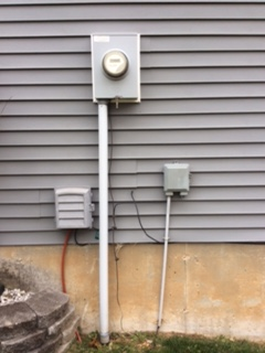

Old 18-Nov-2014, 11:13 PM   #106
Which side of your house is the power meter on?
Where do the coax lines from your antennas enter the house?
Old 18-Nov-2014, 11:19 PM   #107
Also, I am going to begin to look at bringing out an electrician to ground it (assuming it isn't currently grounded). Is the only thing I need materials wise a single grounding block?
It's only one grounding block, but it will accept two coax lines. There are also grounding blocks that only accept one coax line, that would be called a single. If your two coax lines enter the house at about the same place, then you can use the dual block. It should be mounted outside, just before the lines enter.
The electrician should be able to supply the 10 gauge copper wire used to connect the block to the house electrical system, as per the diagrams I posted.
Since you will have three 10 gauge wires, two for the masts, and one for the grounding block, an IBTB would make life easier for him. Most electrical supply houses will have it. Otherwise you will have to give him one to put near the meter.
The coax from the 91XG and C2V enter through the roof into the attic.
The power meter is on the east side of my home (the same side that I took the side photos of the antennas).
I was looking at the surge protector I have in the attic when I was doing the attenuator tests and noticed the "grounded" light was on. Not sure why though. I don't have any grounding blocks that I know of.
mulliganman is offline   Reply With Quote
Old 18-Nov-2014, 11:41 PM   #109
Good, that will make it easier for the electrician.
That just means that the surge protector power strip was connected to a 3-wire outlet that is working like it should.

Satellite image with green lines added to post #104, as per your OK.
I have to leave now; will be back when I have more time.

Earlier in the thread we were thinking about moving the 91XG to a better location, because Fox is your weakest signal that needs a high gain antenna and an amp.
But, since it is doing well at its present location, and the C2V isn't doing very well for the other stations, I think the C2V should be moved to the best location on your house.
That location is at the rear of the peak of the higher roof on the west side of your house. The signals from the NE will clear the house that is east of you when the C2V is there.
This is what the signal lines look like at 45 degrees Bird's Eye view:
And this is what they look like at 90 degrees vertical view:

Also is there any way you could provide me a photo in a pm like before marked with exactly where you are suggesting?
Done.
