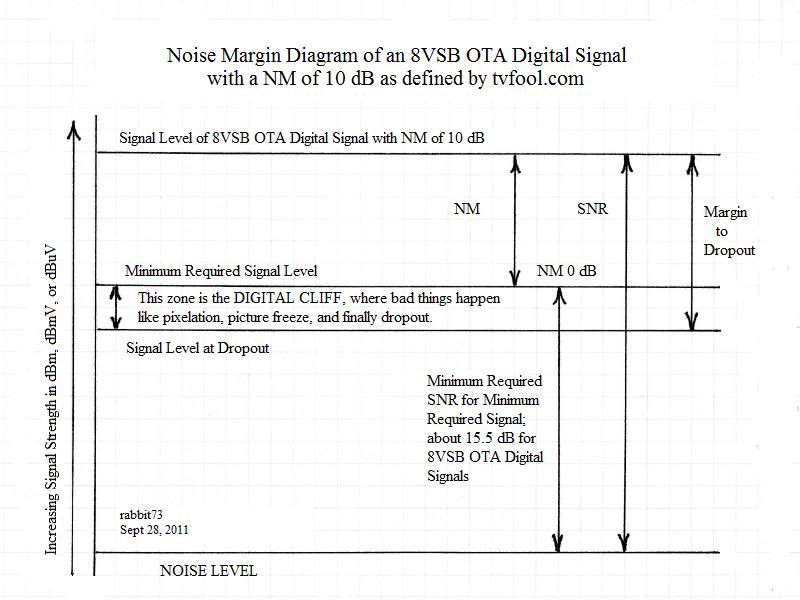

Old 3-Nov-2014, 4:08 PM   #27
Their reply was to be without issue, signal strength on all channels needs to be in the 80-100% range, RS Corrected and RS Uncorrected has to be 0, and SNR Levels have to be in the 30-35 dB SNR.
Those reading would be ideal, but your own tests have shown that for satisfactory reception the signal strength can be lower, and the SNR can be as low as 18 dB (15.5 dB at 0 NM is minimum). I do agree with them about the errors.
Is there any equipment that could put me at those levels?
Maybe, but it would be more expensive than necessary.
Thank you for addressing this! I told them I felt like it would be quite difficult for all OTA users to get to those levels to which they replied that they were sure there was equipment that would do it.
What I wasn't sure about is whether an increased SNR strength number correlated to no error messages (RS Uncorrected and RS Corrected numbers). That's a big reason why I wanted to know if those numbers they suggest are realistic.
While Tivo has the most superior OTA DVR, I feel their customer support for OTA users is lacking.
correct
Their readings are based on standards for cable systems for digital signals (QAM). The 8VSB OTA signal contains a pilot signal that helps with marginal reception; the QAM signal does not contain a pilot signal.
33.1 KSPR real channel 19 is your strongest signal. It could be getting close to an overload point somewhere in your system.
