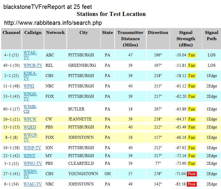

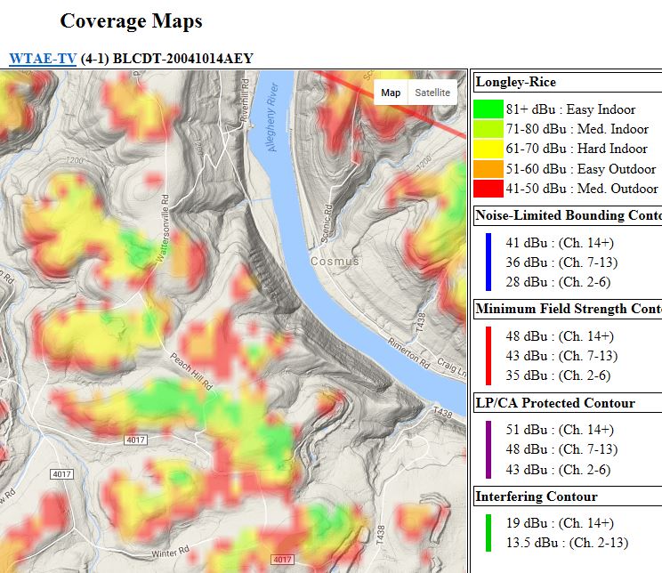

Your report indicates you should be able to get WTAE 51 with your CM antenna and a preamp. It is listed a being much stronger than WWCP. RabbitEars.info lists it as being stronger than KDKA at 25 feet:
but the coverage is very spotty in your area because of the rough terrain:
Have you tried to get WWCP by aiming your CM antenna at 158 degrees with a preamp?
If you want to keep your CM antenna aimed at Pittsburgh for UHF and VHF with a preamp, you can try this inexpensive VHF antenna aimed at 158 with a preamp for WWCP:
http://www.newark.com/stellar-labs/3...vhf/dp/71Y5462

When you look at the terrain coverage map just above, I am right by the bottom of the the "LL" in Hill.

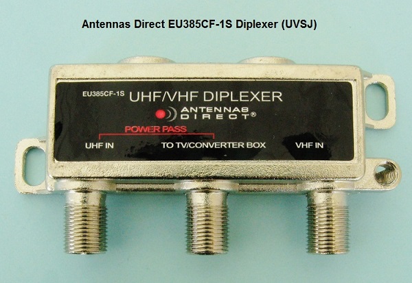

Both of those devices are wrong for combining a UHF antenna and a VHF antenna for the CM amp (which you didn't tell me the model). You need a UHF VHF Separator Joiner, UVSJ, AKA Diplexer.
https://www.radioshack.com/products/...itter-combiner
https://www.antennasdirect.com/store...Combiners.html

Combining a UHF antenna with a VHF antenna with a UVSJ works OK.

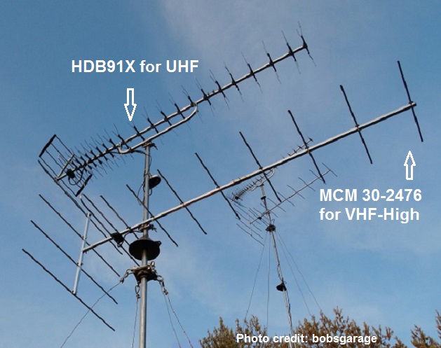

I understand that you want UHF and VHF from two directions, the SW and SE, but using a splitter in reverse probably will not work for you.
Forum member bobsgarage lives between Chicago and Milwaukee. He wanted both direction, but I told him to be happy with just one direction because combining doesn't always work. He tried it and lost some channels. He ended up with two separate systems.
Bobsgarage lives north of Chicago, and has two antenna systems on two separate masts; one UHF/VHF system facing north to Milwaukee, and one facing south to Chicago. (In the photo, they are both aimed in about the same direction.) He wanted so many channels, he found it impossible to combine them without losing some. He is using separate tuners.

The best solution I can think of for you if you want both directions for UHF and VHF to 3 TVs, is UHF and VHF antennas for both directions (or a UHF/VHF combo antenna for each direction) with a preamp for each direction, and two coax lines to each TV.
One coax line will go to the TV antenna input, and the other coax line for the other direction will go to a separate tuner with its output going to the aux input of the TV.

If your report is correct, you shouldn't be having trouble getting WTAE, even with the CM antenna and a preamp.
One disadvantage of the DB8e is that it has a narrow beamwidth that might not be able to cover all your SW channels.
Would a separate tuner be needed for each TV?
