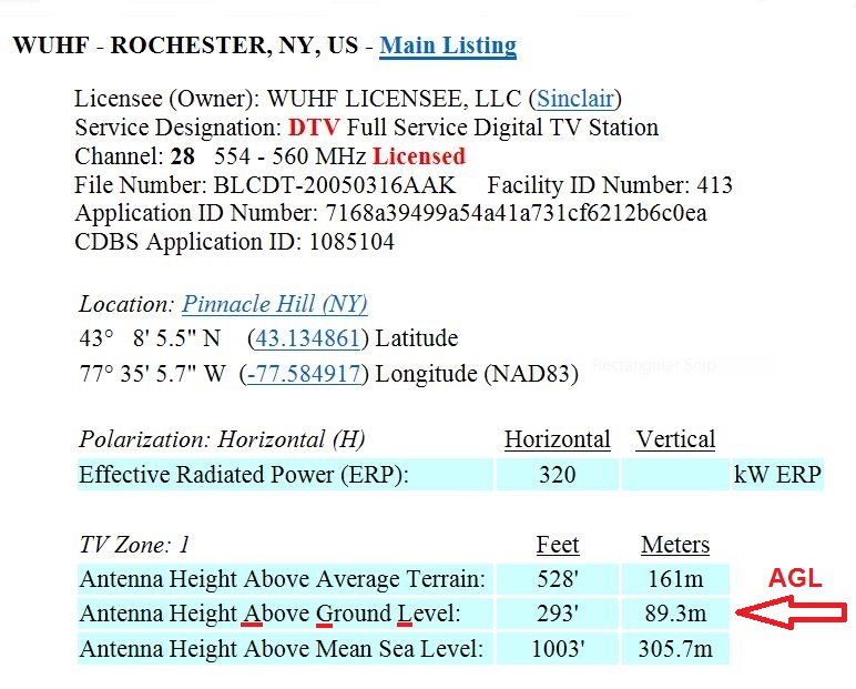

The FCC uses AGL to describe the height of the transmit antenna on a TV tower.
That is true.
