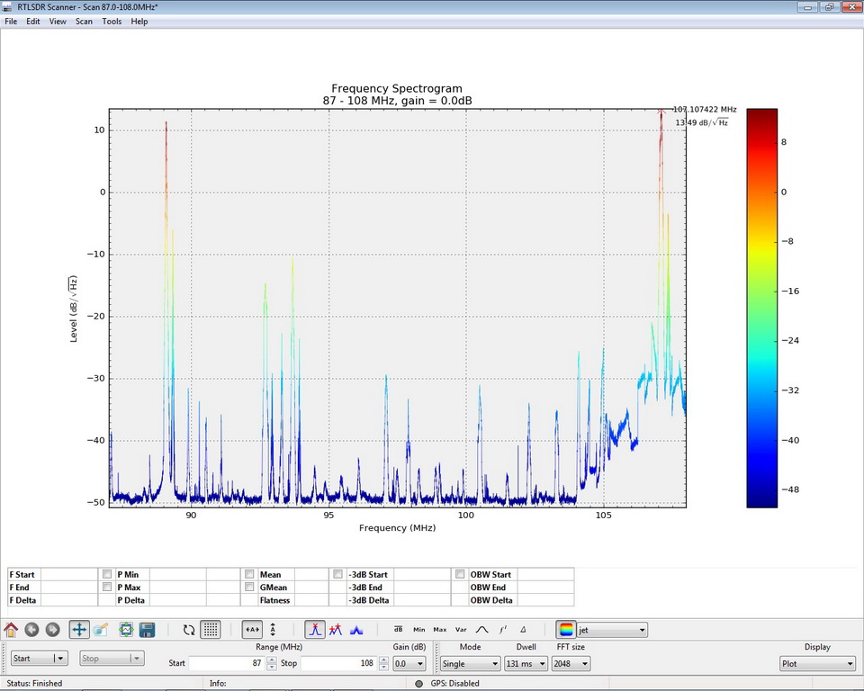

Well, since I have multiple threads going, I'm not sure where to post this. I got the SDR configured with RTLSDR scanner and found a surprise, but not a good one. It's a land mobile radio service on the same tower. Note, the FM stations are attenuated by 2 filters and a small amplifier is inline. I think I have to rethink my high pass filter. The calculated cutoff is 160MHz. I'm also including the FM band with no filters for comparison.

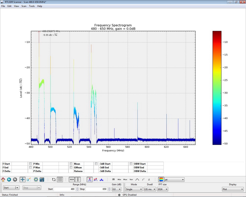

I'm back with an update. I now have a 4-bay M4 10x9.5 with a flat reflector. I have monitored my reception for a few days and it is much better with this antenna. One thing that still puzzles me is the fact that traffic and parked cars affect my reception. That means part of my signal is reflected from the street surface, right? I also have the huge hill that prevents LOS reception. I'm wondering if a slight tilt toward the top of the hill would help? By the way, here is what I am receiving on UHF. Note that CH26 is not the strongest channel because the antenna is not pointed that direction but that is constantly varying.

Thanks for the updates, Chris. Your SDR is almost as good as a spectrum analyzer at finding interference to your TV reception. Is that signal at 152.48 MHz the land mobile? You do need to rethink a high pass filter, because a HLSJ isn't going to take it out. Maybe a coax stub and a "T" adapter can attenuate it enough.
Yes, you would notice it most with the moving vehicles.

Interesting but I think some of my usable signal is from ground reflection. Could be wrong. But moving the antenna to a position as shown would require longer cable and possibly put the antenna more in the shadow of the tall college building across the street. It is pointed to the right of it now. At least with the SDR, I can try it with a laptop instead of moving a TV, lol. I wonder if there is a point at which the antenna height brings in better signals. 25 ft is the highest I had the other antenna and there was no sign of my weak channels between 17 and 25 ft.

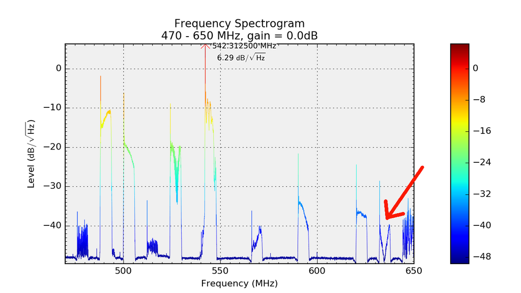

I was looking at this site and the section on Ground Reflection explains a lot. Sometimes the ground reflections help and sometimes they hurt. They also vary with frequency. This graph shows what CH 41 (red arrow) looks like when I can't receive it.
Yep, that severe notch is going to be due to multipath due to one of its several forms, which is always due to having a blocked signal path and having to rely instead on various reflections which may arrive at the antenna in either and additive or a subtractive manner. That one is "subtractive" in the middle of that channel's bandwidth. Move the antenna a couple of feet in any direction and the received signals will change.
