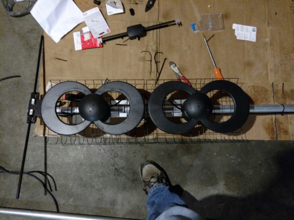

SO are you saying that if I kept the UHF elements the same orientation but stacked vertically I would end up with the same gain but keep the 70 degree HPBW? I think that would suit me based on my report!
Looking at the installation manual I think I can stack the loop elements and have the combiner bar connections on the loops facing each other and maybe this would still allow the combiner bars fit right up?
Old 29-Jan-2016, 12:50 AM   #48
Yes, more or less the same.
No. You cannot do it with the C4 combiner without really messing up the engineering of the phasing bars.
You'd either have to start with two C2 antennas and make a combiner (out of coax cables and a two port splitter, for example) or, if you have a C4, use standard baluns (matching transformers) to match to the same homemade combiner.

I guess my view is a little fuzzy at the moment. I see what you're saying but I'm not sure without trying that it cannot be done with the current phase bar/combiner.
I say this because the two loop elements are the same so if you flip one of them 180 so the connections are at the bottom then place that one on top of the other so the connection face each other, the orientation for the connections should be the same for the phase bars. See my sketchy 2 min sketch of what I mean attached.
Like I said, dimensionally I don't know until I try it. Maybe you have some parts and pieces you can try?...lol
It won't work without mangling both metal and performance. Forget it.

Vertical stacking the C4 loops didn't work. FOX was gone and WPXT and WPME were weakened.....
I raised both antennas 5 feet now and placed the dipoles on top. I'm now getting WCBB and WENH solidly.
