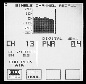

Good signal strength but poor signal quality is a symptom of multipath reflections that damage the signal.
I have that problem with my GE 34792 attic/indoor antenna and CH13.
This single channel scan with my Sadelco DisplayMax 800 signal level meter shows notches in the signal, indicating multipath interference. Plenty of signal strength, but no lock on the signal.

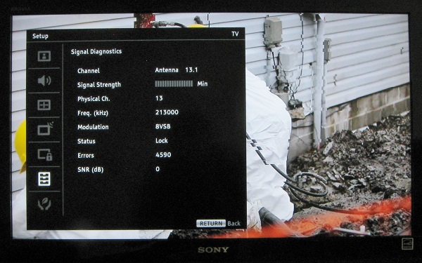

Sony Diagnostics screen shows picture freeze, many errors, and SNR 0 dB.

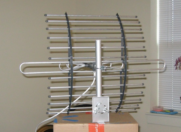

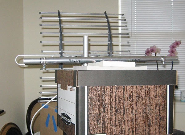

I suspected that multipath reflections were causing a problem and decided to add a reflector element to the VHF folded dipole. A cardboard box is used as a temporary support.
The reflector is 13" behind the VHF dipole and consists of a 24" length of 1" aluminum tubing with a 12" length of 7/8" tubing in each end and clamps. The length has been adjusted to 27.7". I also tried a strip of aluminum foil on a yardstick with the same results.

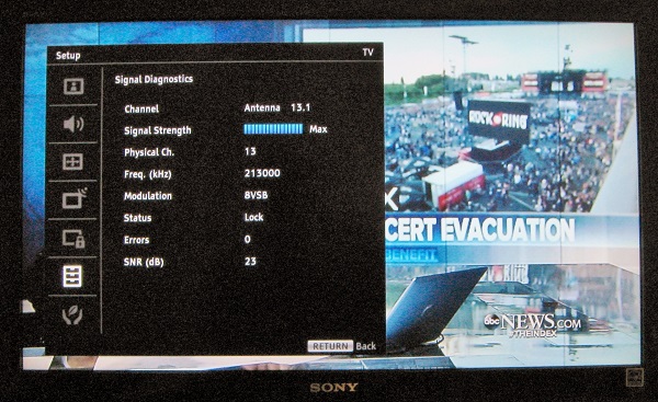

The reflector improves the reception:
and the scan looks a lot better:

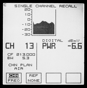

Since the convenient location for the antenna had some problems, I tried other locations in the room. The best location for the signal was in the middle of the room in a high traffic area (of course it was).

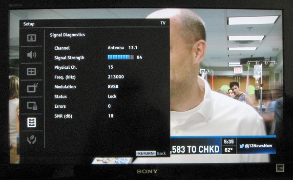

No reflector was needed in this location and the reception was excellent:
and the channel scan looks good, with increased signal strength:
