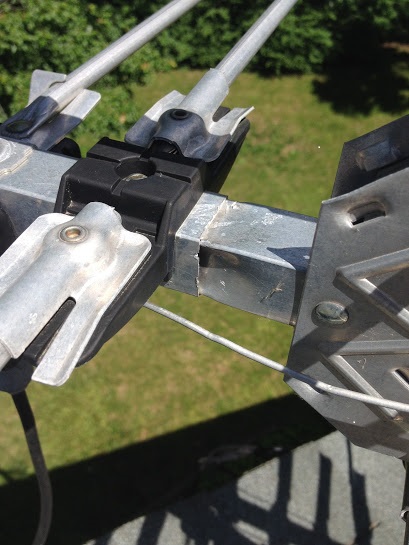

I am wondering if the connection between the UHF and VHF elements on the antenna is the issue - see pic.
https://goo.gl/photos/vT6N7UQ7MoGwJFNMA
Yes, it could be the issue if either of the wires from the UHF section touch any metal parts of the antenna on their way to the CB-8269.

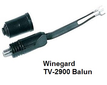

Can you recommend a balun w/ clips like the one in the video?
I used to recommend the Channel Master 94444, but they redesigned it but kept the same model number.
http://forum.tvfool.com/showthread.php?t=16297
The WINEGARD TV-2900 gets good reviews.

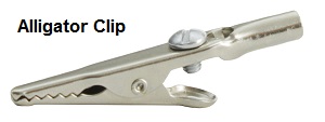

Add two alligator clips that have screws.

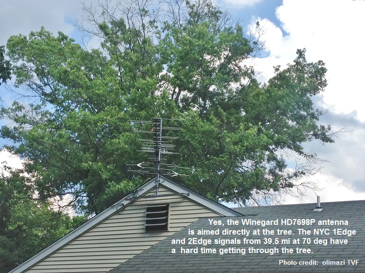

I have a large pin oak in front of my antenna that has gotten even bigger since a tree in front of it fell a few years ago. This is most certainly what is causing my signal loss.
Would a different antenna with a wider beam-width help me?
or do I need to find another spot for my antenna...
I may try it in the attic, as I've noticed lower on the mast was getting better signal.
https://goo.gl/photos/ftoSpy92H8tkj1bC6
olimazi is offline   Reply With Quote
Old 22-Jun-2017, 8:41 PM   #26
Thanks for the photo.
If the tree is between the antenna and the transmitting tower, that would certainly block the signals.

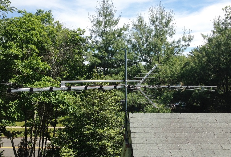

Something doesn't look right in the photo. Maybe I'm getting the mast confused with the boom, or maybe it is just the angle that was used for the camera location, but the antenna looks like it wasn't assembled correctly. Can you show us another photo of the antenna taken at a different angle, maybe more from the side?
Your situation looks a lot like this:

Here is another pic (may have to bite the bullet and turn it to philly
https://goo.gl/photos/AoqbjMa4cgxbTepc9
Old 23-Jun-2017, 4:17 AM   #28
Thanks for another photo; looks good to me!
http://www.hdtvprimer.com/ANTENNAS/siting.html
scroll down to Trees and UHF
Old 23-Jun-2017, 4:31 PM   #29
I have added your photo to my collection of classic tree photos.

Out of curiosity, would these horizontal metal screw threads coming from my u-clamp on the mast have any affect on my ota reception?
https://goo.gl/photos/AxHYeM4gQqjVtFgE7
Old 7-Jul-2017, 1:16 PM   #33
JoeAZ
Join Date: Mar 2017
Posts: 418
The bracket on your 7698P is entirely different than that
on my 7694P. I cannot help but wonder if the slotted screw
is grounding out your system????
