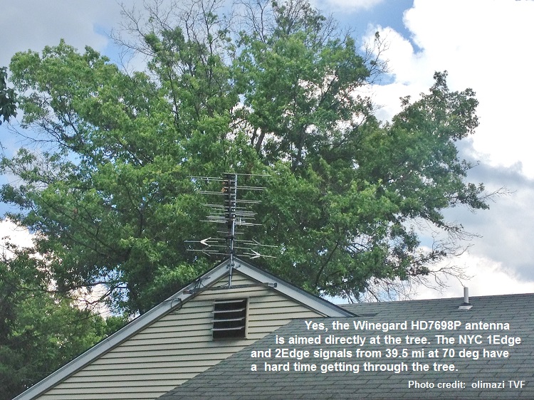

At first I thought it was the pin oak in the line of sight, but it has since lost all it's leaves and I have the same issue.

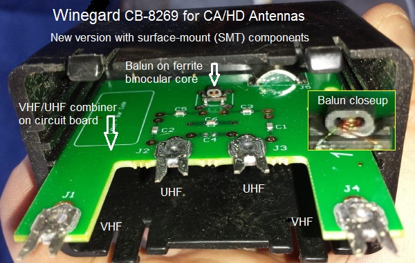

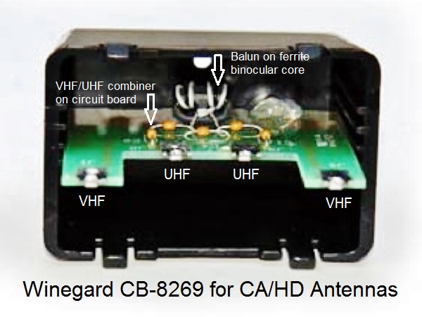

Yes, the balun is inside the housing for that antenna. At this point, you must consider that any part of the system is suspect and it will be necessary to substitute each, one-by-one, with a known good part, even if it means that you end up with a completely separate system. That seems like a lot of work, but it is easier than guessing.
The CB-8269 Cartridge Housing has been known to have problems; I consider it the weakest link in an otherwise good design. There is a troubleshooting video by Winegard:
How To Troubleshoot a Winegard Antenna Cartridge Housing
https://www.youtube.com/watch?v=TlQk...ule1MX8jCAfvPQ
http://forum.tvfool.com/attachment.p...1&d=1499537712
http://forum.tvfool.com/attachment.p...1&d=1499537896
http://forum.tvfool.com/attachment.p...1&d=1499538211
http://forum.tvfool.com/attachment.p...1&d=1499538454
http://www.solidsignal.com/pview.asp?p=cb-8269
http://www.winegarddirect.com/viewit...(CB8269)&post=
interesting mod
https://www.youtube.com/watch?v=mpZNtxy4INM
He soldered the external balun wires to the prongs, but that doesn't improve the connection between the prongs and the wires from that part of the antenna.

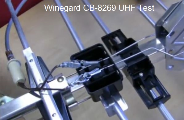

Did you do the troubleshooting test shown in the first video to see if both sections of the antenna are working OK?

Yes, that is the way it has been designed, which is unique to that series of antennas by Winegard. Most other antennas combine the VHF and UHF sections in another way using shorting stubs.
http://forum.tvfool.com/attachment.p...1&d=1483889050
in RCA ANT751:
http://forum.tvfool.com/attachment.p...1&d=1483891000

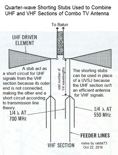

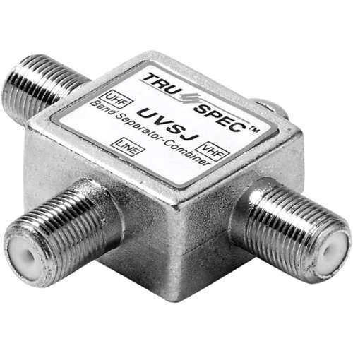

The CB-8269 does two things, it combines the VHF and UHF sections so that they don't interfere with each other, and its internal balun converts the antenna to 75 ohms for the coax downlead.
You could do a custom modification as done in the second video above. Connect a balun to the VHF section and another balun to the UHF section and combine them with a UVSJ.

olimazi 9-Jun-2017 8:33 PM
Guys, I swapped out the balun with a new one and it did not help my reception, sigh.

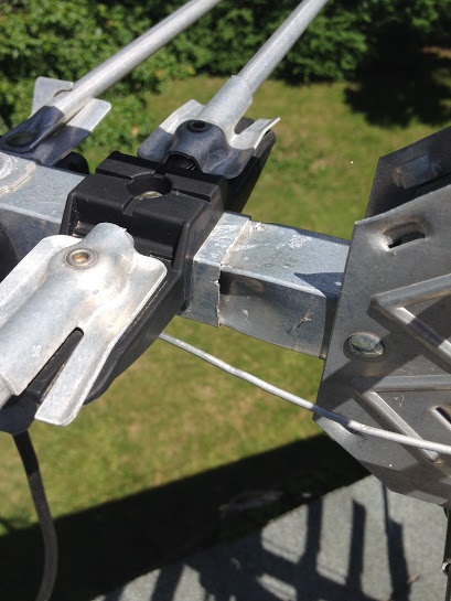

I am wondering if the connection between the UHF and VHF elements on the antenna is the issue - see pic.
https://goo.gl/photos/vT6N7UQ7MoGwJFNMA
rabbit73 10-Jun-2017 2:36 AM
The next step is to test each section of the antenna for reception as shown in the Winegard video.
olimazi 12-Jun-2017 6:48 PM
balun
thanks rabbit... the video shows how to troubleshoot the balun to see if it is the cause of poor reception... but I have replaced the balun with a new one, that would eliminate the balun as the culprit.
I did notice the uhf/vhf lines coming into the balun had some oxidation going on, if you will - from moisture? I will try to scrape that off/file it down to see if my reception improves.

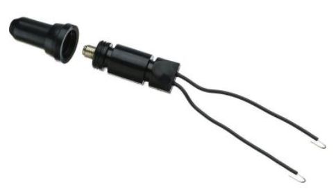

The video shows more than that. It also says to test each section of the antenna for proper reception using a conventional balun with clip leads connected to the UHF section and then the VHF section without using the CB-8269.

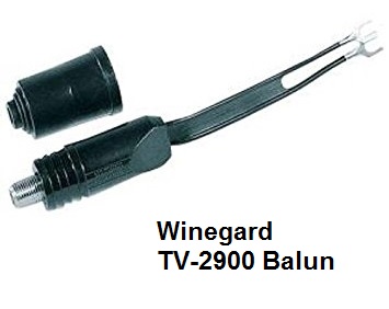

OK. So if I test with the clips and one part of the antenna is bad, then I guess I need a new antenna?
Can you recommend a balun w/ clips like the one in the video?
