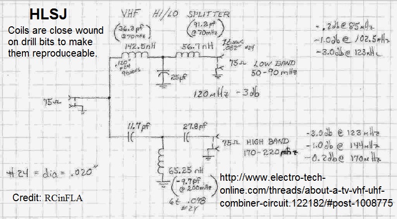

I added a picture (wish I could show the picture or a thumbnail.
I can display it for you; nice job, chris.

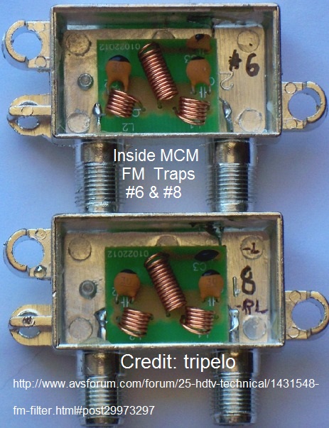

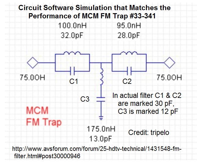

This is what the MCM FM Trap looks like inside:
diagram

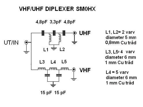

Do you happen to know what is inside an HLSJ?
Inside is a low pass filter and a high pass filter, just as there is inside a UVSJ, but for different frequencies. The general term for these filters is a diplexer. All UVSJs are diplexers, but not all diplexers are UVSJs.
Here is a DIY 5-pole Diplexer, AKA UVSJ:
DIY photos
http://www.is0grb.it/duplexer/
DIY 3-pole HLSJ; 5-pole would be better:
source:
http://www.electro-tech-online.com/t...ircuit.122182/
post #12
http://www.electro-tech-online.com/t.../#post-1008775

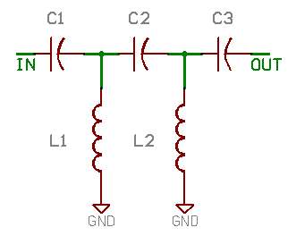

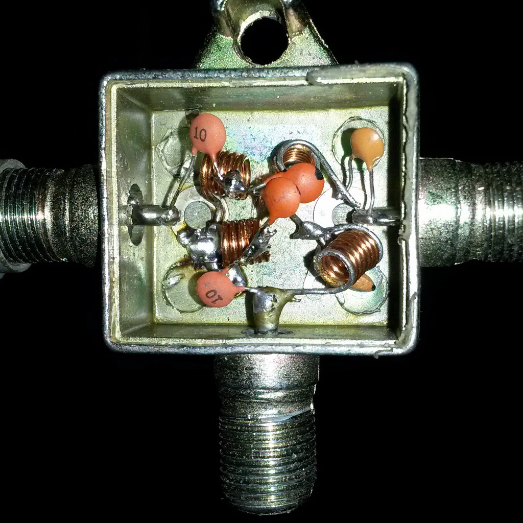

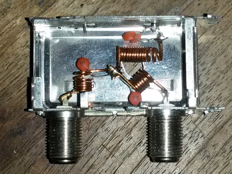

Thanks for the information. I looked inside the HLSJ I got and the component values are more consistent with UHF/VHF splitter. I left the low side alone and put a 5 pole chebyshev on the high side. 160 MHz gave me convenient values.
Part Values
Part Chebyshev 0.1 DB
L1 0.048 uH
L2 0.048 uH
C1 10.19 pF
C2 5.92 pF
C3 10.19 pF

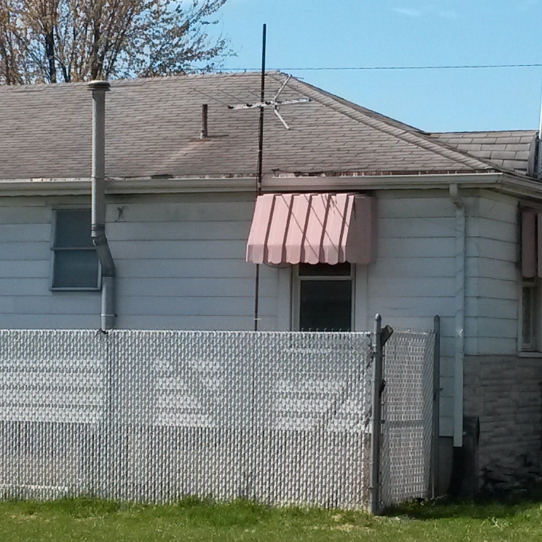

Well, I'm about to give up. I have moved this antenna up, down and even back a few feet. That is about 15 ft. in the picture but I have tried as high as 25 ft. It works better when the antenna is lower than the flue pipe. Some things just don't make sense. When cars go by, the signal changes. WCHS gets lost by lowering it. WOWK and WVAH get lost by raising it. WOWK has a decent signal when it breaks up or cuts out. I'm thinking multipath? Is there anything in the picture that screams "fix me"? If not, what antenna do I need that is reasonably priced?
Yes! You need lot more metal in the air and more height to reliably receive the stations shown on the signal report in your first post on this thread. If you are aiming for the stations in the arc from 99 to 108 degrees magnetic, then you need a fair amount of gain for real channel 13 (VHF-Hi) and very high gain for the others (UHF). Even then you may encounter problems with the stations showing negative NM in your report. Some of the others on the board can make better suggestions than me, but if I were in your shoes I would probably try an 8 or 12 element VHF-Hi antenna and a long yagi or 8-bay bowtie for UHF.

Old 25-Apr-2016, 12:45 AM   #40
That's normal; you are getting a reflection from the car. It's called dynamic multipath.
Yes, you are geting reflections off metal objects like the gutter, awning, and fence that can interfere with or enhance the direct signals. It's called static multipath.
