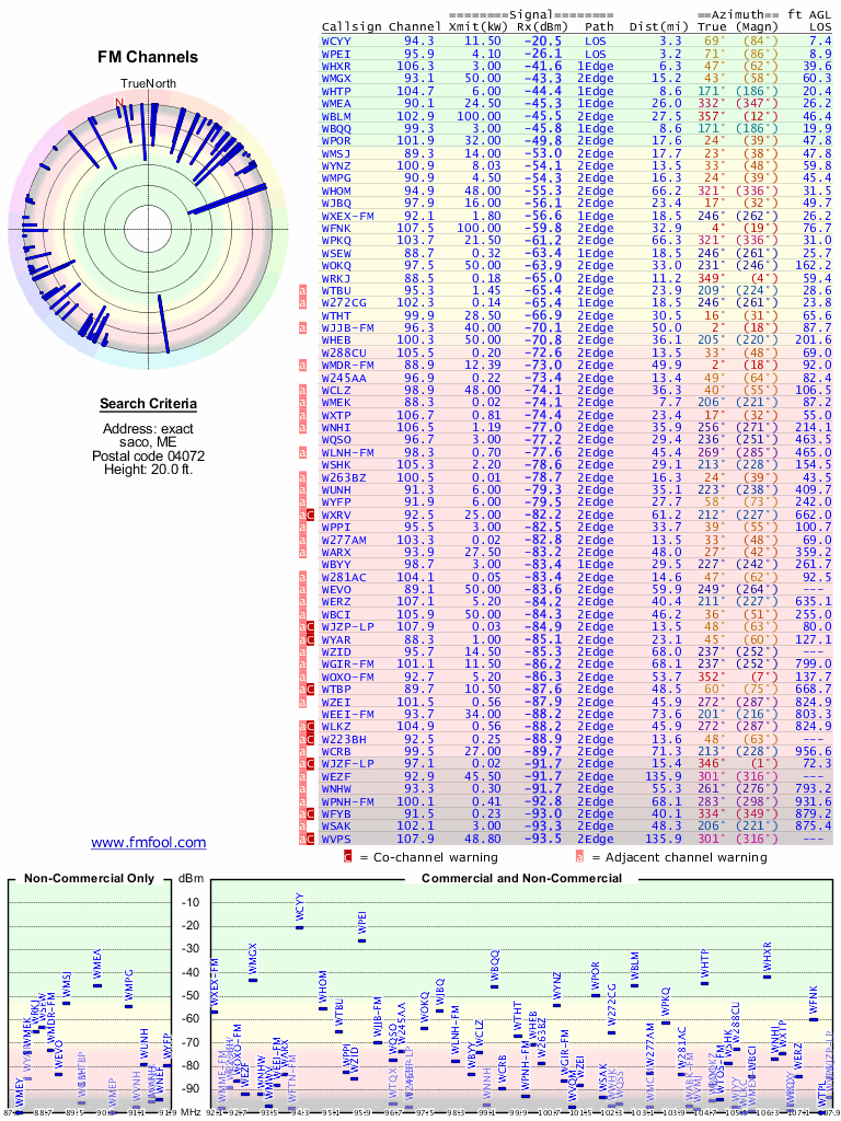

That doesn't take me to your FM report, it takes me to the page to enter your location. FM reports don't link the same way that tvfool reports link. Based on an estimate of your location, this is your FM report. You can see how close I came:
http://www.fmfool.com/modeling/tmp/a...4/Radar-FM.png
Old 14-Jan-2016, 3:28 PM   #29
shoman94
Join Date: Jan 2016
Posts: 138
That sounds like a good clue.
I don't know what happened there..... I guess I can't post it the same way. See attached.

This TVFOOL: http://www.tvfool.com/?option=com_wr...51347570c1f198

Assuming that channel 33 is real channel 3, then you will need to point your VHF element at 257 mag. and channel 11 will need the VHF pointed at 253 mag. If you have it pointed the same as your UHF at 21 mag then it's aimed the wrong way.
You might try to split the difference, but, channel 33, (3) has a NM value of only 1.8 and it's a 2 edge so you may never get it without a large old school VHF antenna. (If then.)
Old 19-Jan-2016, 2:28 PM   #36
Real channel 33 on his plot is WPXG, the ION affiliate from Concord, NH, virtual channel 21. It's off the back of the C4V and it would not be expected to be received at those forecasted levels off the back of any antenna than has any F/B ratio greater than 0.
WORK-LP is presumably still operating under their STA at a measly 58 watts ERP while they wait out the FCC's spectrum actions. That meager signal will never make it to this location.
My FM traps and Preamp are located indoors 30 feet from the antenna
You would improve your system noise margin by at least 2 dB if you put the amp immediately at the antenna as is customary.

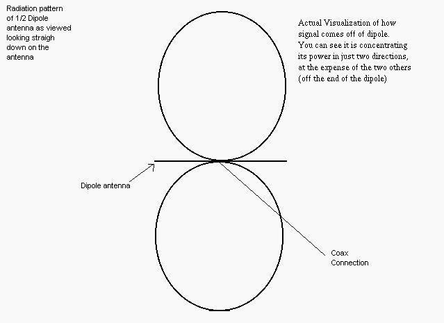

Originally Posted by shoman94 View Post
The VHF are Di-pole's... I'm not sure it has any gain is any direction.
A dipole antenna does have gain compared to an omni-directional antenna. It is directional. The maximum signal is received broadside to the antenna on each side making a dipole essentially bi-directional. A dipole receives very poorly off the ends of the antenna elements.

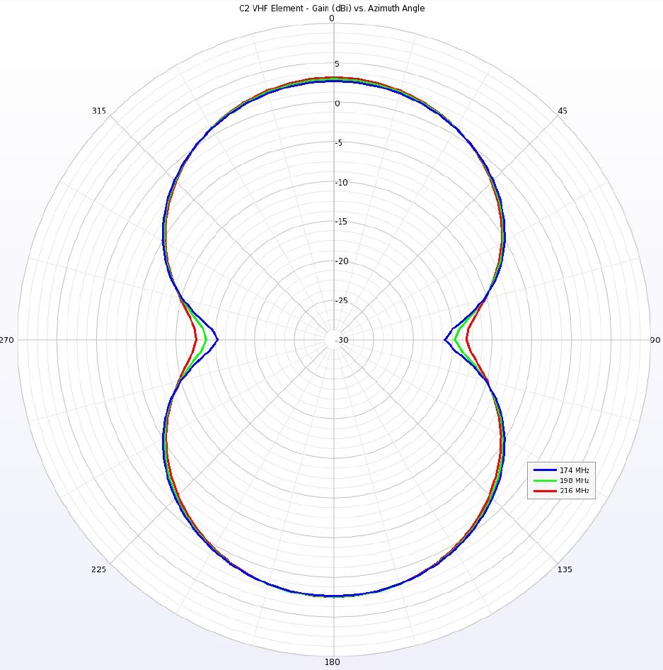

Ok I found the chart (see attached) and look like I would benefit to aiming the dipole separately from the panel. Thanks for that.
