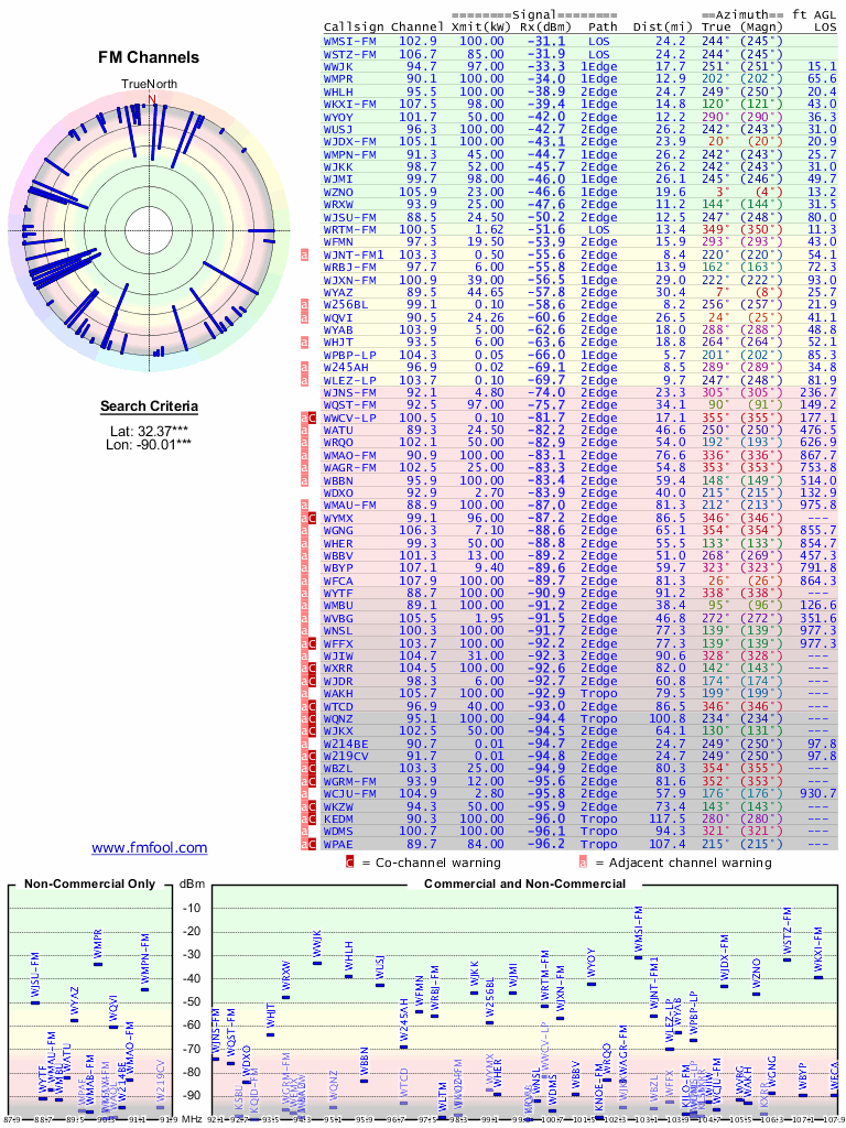

It will help us understand your situation better if you can provide a TVF report that accurately predicts the conditions at your location.
From the other forum here's his real TV & FM fool reports:
http://www.tvfool.com/?option=com_wr...5747363b1c7c22
I don't see any glaring problems.
