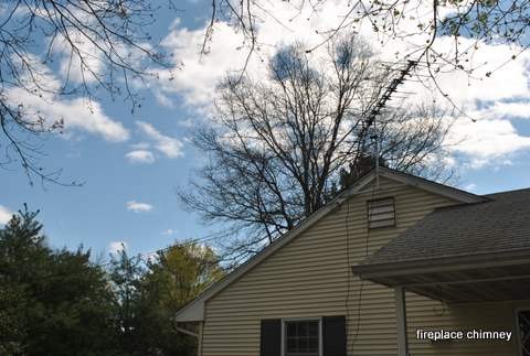

Thanks, it's ch 44 that's getting drop outs - weak 0-35% signal fluctuating.
I'm gonna get on the roof and re-aim the antenna - originally was supposed to aim right at a tree, but i shifted it a few degrees so it's not directly at the tree - since i visualize the signal wrapping around the tree-i grab it on it's way around.
Fox in NYC is available as channel 5.1 in HD on UHF 44. It is also available in SD as 5.2 on UHF channel 38. Similarly, channel 9's programming is also available as sub-channels but on the opposite frequencies. If you're getting 9.1 and 5.2 but not 5.1 and 9.2, then you're missing the signal carried on channel 44.
I'm also concerned that when the maple tree fills in i will have more issues (attached pic). Haven't tucked the downled into the siding yet
Your new antenna is a very large one with a significant wind load. Don't be afraid to install guy wires, if needed to prevent it from coming down and damaging your eave in the process.

Hey guys, just wanted to give an update on my OTA antenna situation.
I was getting dropouts in the spring/summer when the tree in front of my antenna (pin oak) filled in and I was constantly getting on the roof to re-aim it between the limbs to catch a glimpse of the Eastern sky.
During Hurricane Sandy a large Blue Spruce fell on the house - this tree was also in direct line of sight to the tower.
Turns out this tree was the culprit to my bad reception - after it went down my signal was perfect - no drop outs - even with the pin oak in full bloom.
