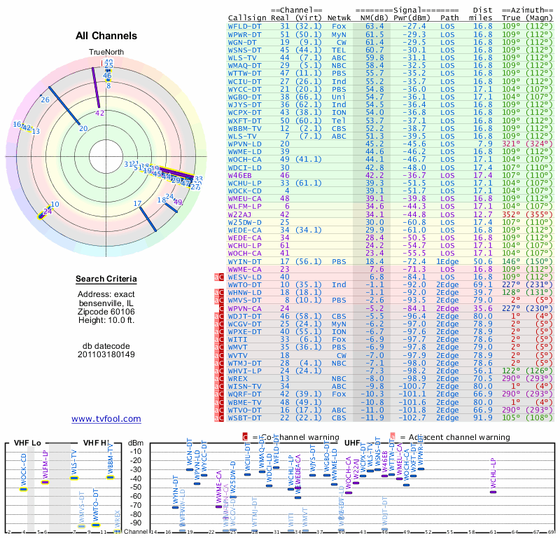

didnt post , trying again - see attachment

Save your money. You don't need to spend a lot of money to get excellent reception. I suggest either this antenna or this one. If more than 2 or 3 sets will be connected this is the best bang for the buck.

A non-amplified set of rabbit ears will work.
The HD7964P and HBU-33 are both excellent, premium solution options.
An RCA ANT-751 is plenty of antenna.
The C5 is also an excellent product, but not a UHF design. With the signal levels at your location, it would likely work, but is not the best choice.
The first two suggestions, can recover enough signal to insure excellent signal levels after splitting the signal to as many as eight sets. The RCA can drive at least four.
Regardless of antenna choice, aim at about 110° per your compass.

So now we know , with the radar plot , You are in a High Signal Strength Area with many LOS Line Of Sight Tv stations , and lucky you , you have 'way to many' Tv stations to receive with the main digital channels and sub digital channels. Yes the Winegard Hd7694P antenna will receive real fine and will provide plenty of signal power to the Tv's. You will not need a antenna amplifier.

We have answered your last questions already. And the Only way to find out about how well the HD7694P antenna will work in the attic is to put it in the attic and see what happens. Do Not use a amplifier. The strong signals at your location are very strong and a amplifier will cause problems with reception from over loading.

An attic antenna may very well work. Because signals reflections that can occur with varying degrees in an attic environment, some stations may pixelate. The only way to know for sure is to try it. Just wanted to make sure you would be able to get the antenna back out of the attic in case reception isn't satisfactory. IMO, the HBU-33 would probably be the best bet since it folds back up easily. The HBU-22 or ANT-751 may work, but might not have enough juice to power additional sets.
The signals levels at my location are even stronger, but an attic antenna didn't work well because of the signal reflections.
