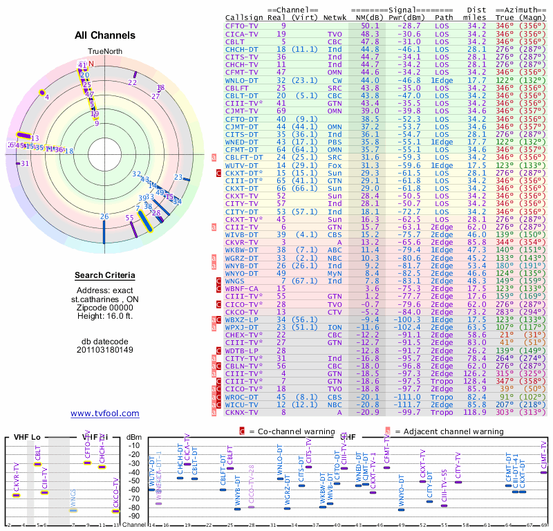

here it is also city tv is fuzzy...........
http://www.tvfool.com/?option=com_wr...8d17f3976f6e6a

My apologies, I did not recognize this as a continuation of your first thread 1482.
Let's discuss your reception separate from your family's. I'll respond in the first thread.
