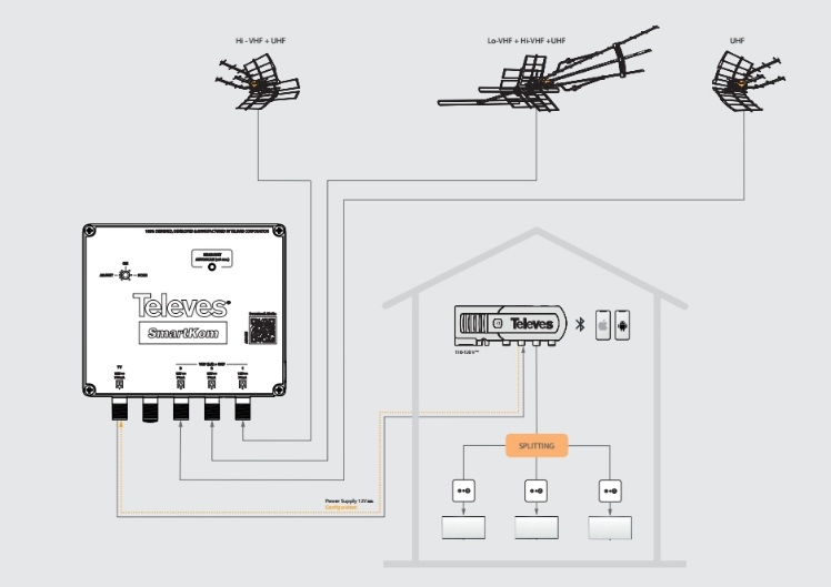

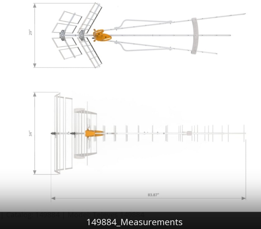

Different markets different directions.
Which markets are you after? Austin looks pretty good. Then you have a couple other markets. If you need to get the other two which are definitely doable you will need to have a different antennas, with a aTeleves SmartKom.
I would put a DATLR Mix 149884 an aim at Austin. I would get a second 149884 and aim at San Antonio for your largest selection of stations. You could let SmartKom pick your stations..
