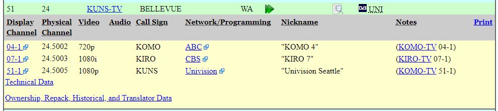

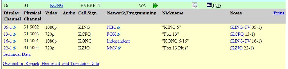

According to RabbitEars.com you have two physical channels broadcasting ATSC 3.0
KONG on physical channel 31 has four streams including NBC and Fox
KUNS on physical channel 24 has three streams including ABC, CBS and Univision

Just go to the Digital TV Market Listings page.
https://www.rabbitears.info/market.php
Find your market (#13 Seattle) and click on it.
It will open up and show all the stations, the ones in green are ATSC 3.0
Click on individual stations in the list and it will open up and show you the subchannels
