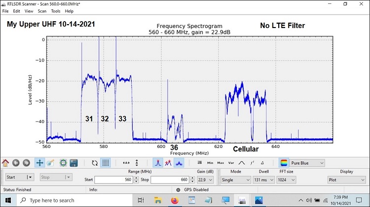

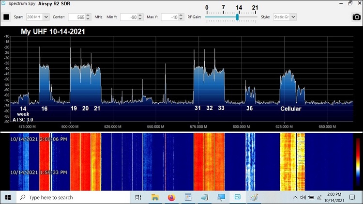

Good idea to try the filter. If you order the Channel Master 3201 filter, make sure you get the NEW 600 MHz filter that says Pass 5-608 MHz Block 609-3000 MHz. They tweaked the 600 filter to reduce the loss to channel 36.
You can see the cellular signals with an SDR:
Video
I use VLC Media Player
Download and view now:
https://www.dropbox.com/s/bvohk4y8hn...MyUHF.mp4?dl=0
Download now, view later:
https://www.dropbox.com/s/bvohk4y8hn...MyUHF.mp4?dl=1
A less expensive SDR ($30), the RTL-SDR.COM V3, can be used with free DIY Scanner software from GitHub. The scan is not real-time; you have to wait until the scan has completed before you see it.
File Type: jpg My Upper UHF 10-14-2021Filter_22.9dB_2.jpg (131.8 KB, 8995 views)

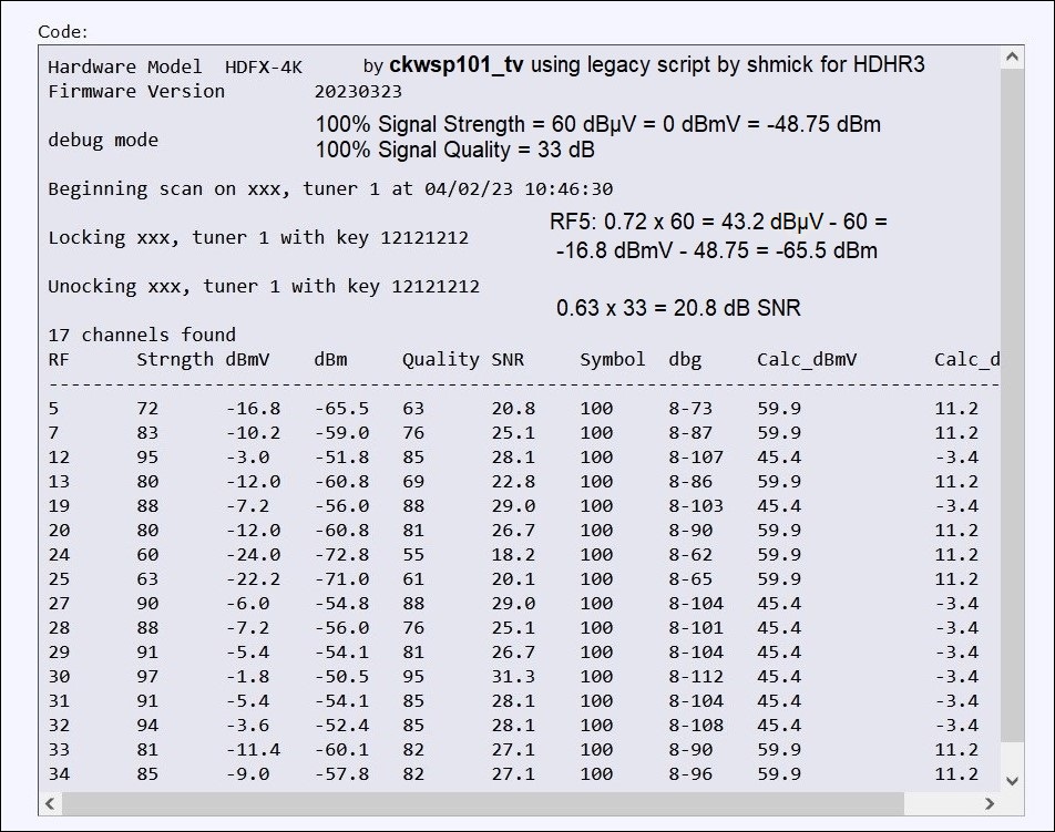

With upgraded SiliconDust tuner fewer reception failures.
ATSC 3.0 lighthouse transmitter at Sutro Tower (RF 7)
Up to 20 percent improvement in signal quality surprising ( in a good way).
Using legacy scripts. Calculated values may be invalid for newer tuner.
Not going to pay for developer software for new tuner at this time.
My trusty Extend failed. Cannot perform A/B test.
Same antenna, LTE filter, preamp and cabling as before.
RCA preamp due for a replacement.
Annoyed one needs to purchase a MS HEVC plugin to receive ATSC 3.0 video with
SiliconDust W10 app.
Too bad stock VLC lacks AC-4 audio support. Can view ATSC 3.0 video with no sound.
updated link
https://www.rabbitears.info/s/944339
Thank you for the interesting update with the data from your HDFX-4K using the legacy shmick script.
I haven't been posting much on this forum lately; mostly on the AVS forum where there is some controversy about DRM and ATSC 3.0.
I changed my password for this forum when the certificate hadn't been renewed, and I forgot to write it down. After a little trial-and-error, I recovered it.
You might be interested in this thread, if you haven't seen it, where I mentioned you a few times:
How to display SNR in dB and Signal Strength in dBm on HDHomeRun Config GUI
https://www.avsforum.com/threads/how...g-gui.3270642/

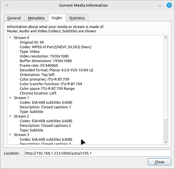

Turns out SD Extend transcoded streams did not saturate my obsolete home network.
Need newer switch to support multiple Flex 4K ATSC 1.0 streams.
I'm time shifting OTA shows to bypass commercials.
Fewer network concerns with ATSC 3.0 streams.
1080p/60 coming from ATSC 3.0 station :>
My VLC client cannot decode AC-4 audio :<
