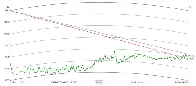

Cotton, looking at your signal report it looks like the Knoxville stations to your west might be difficult to pick up at your location. Seems there is a big hill or ridge about a mile to your west that is having a detrimental effect to the signals. It is very doubtful that an antenna in any of your windows would work.
RabbitEars shows your Knoxville signals as "Poor" and to have any chance of getting them would most likely require a large UHF antenna such as the 91XG you mention plus a VHF-Hi antenna such as a Stellar Labs 30-2476 and they would need to be outside as high as possible. Even then I would think it would be highly unlikely to get reliable reception from Knoxville based on your signal report. I could be wrong, but that's my guesstimation.

Originally Posted by Cotton View Post
I am planning on putting the Antenna in the basement in front of a window that faces West.
That would not be a very good location for an antenna, Cotton.
